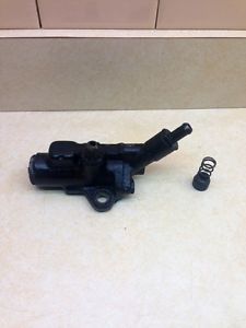

If it does as he says (turns by itself once jacked up) it's the 2 bolts on the top (see pic below) that have to be loosened, then tap the top one way or the other. You will likely have to play with it a few times before you find which way you need to go and how much. The bolt holes are much larger than the bolts so once loosened (not to loose or you'll make a mess) you can fudge it back and forth centering the steering. Good luck $(KGrHqQOKp0FHffS7RvSBR+yRuh+ug~~60_35.jpg

Had the car off the ground and the wheels stay straight so I know the top valve is technically set OK (i.e. not steering the car to one side or another)
