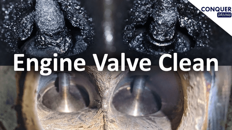

The deposits in direct injected vehicles occur because there is no liquid fuel passing the intake valve face, to clean it. Fuel is injected directly into the combustion chamber, not into the intake manifold where it would have to pass the valve to get to the chamber. This dry intake and valve setup can cake up with soot, since there's no constant fuel "rinse".
The problem is compounded by EGR valves, which can reroute exhaust soot back into the chamber via the (now dry) intake and valves, allowing buildup.
If you've ever had a smog-era car with an EGR valve, and pulled the valve, I'm sure you found soot and carbon buildup in the valve...but only a black oily coating in the intake and on the valves. That's the difference fuel makes. The new direct-injected engines? That soot is everywhere on the intake side.

The intake buildup issue with direct injection isn't oil-based, it's exhaust-soot-based. Go cold-start your Mopar and stick your hand over the tailpipe right after a start, you'll see the soot on your hand. EGR recirculates that back into the engine, especially during cold-start, in order to get the engine up to (emissions) temperature faster and out of cold-start mode ("turns the choke off faster").
A carbureted or mulitpoint-injected (or throttle body injected) engine mixes liquid fuel with the air in the intake, effectively "rinsing" that soot as the engine breathes. Direct injected engines do not - they have dry intakes because the fuel is introduced directly into the combustion chamber and it never sees the intake manifold (or the intake valves). This dry condition is what allows the buildup.
When I was in the service lane we had a TON of issues with it on Mazdas, VWs (esp. TDI), and some of the smaller GM motors. If you have a direct-injected motor and your advisor recommends a walnut-shell cleaning...they aren't bullshitting you. The intake gets pulled and cleaned if needed, and the intake ports in the head are blasted with walnut shell media (with all the intake valves closed) to remove the gunk. It is then vacuumed out and reassembled. Think "sandblasting your intake valves"...but with a media that won't hurt anything if they don't vacuum out every last micron when they're done.
The buildup can cause poor performance through valve stiction, restricted airflow, and lack of valve to seat sealing because of the buildup.
There are also chemicals you can spray in the throttle body as the engine is running, in between walnut cleanings, to help remove smaller amounts of buildup as a maintenance "thing". The chemical won't do much if you already have enough buildup to cause a running problem, but if you spray it every oil change it'll help keep it from getting to that point in the first place.
