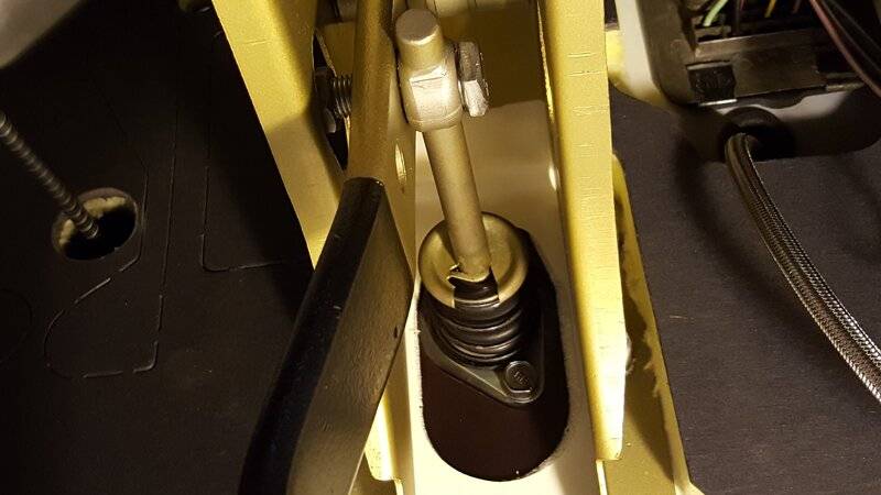

SSBC kit - GM MC setup. Among the 'questions' is proper pedal ratio. My car was manual brakes so conversion to power. Mopar OEM setups had a bell crank pedal linkage; but the GM setup doesn't call for this. The pedal arm has two holes one for manual and lower one for power; mine is still in the top hole as it aligns well with the booster rod. Among the fix hunt was pondering on this though. If I angle the booster I could connect to the lower hole (with some other chit I'd have to do). GM setups if you recall the booster/mc was angled - a noticeable odd look on the older gm power brake systems. As I understand they did this for two reasons: accomplish power brake pedal ratio and 2nd clearance for BB motors. Manual calls for around a 6 to 1 ratio where power is more 4 to 1. I see kits having angled booster brackets to do this or you can buy them separately. Anyway - as mentioned I need to assure the booster rod travels far enough into the mc, and will take the added move to put in a new booster, one or the other 'should' be a fix. Ahh, no longer have supreme confidence after all this friggin time. If that don't do it will look into angling to mate with the lower pedal hole. If not I'll add a garage door return spring...lol
Sounds like a similar mount to mine. I have the 2:1 toggle on the booster mounting bracket so I hooked the linkage to the lower hole on the pedal arm. The feel is about right, still need to push the pedal relatively hard, pedal comes up to a good height (when cold). I'll report what I find tonight. Kinda thinking a heavier spring inside the MC, not that I really want to re-bleed etc. Yuck.
