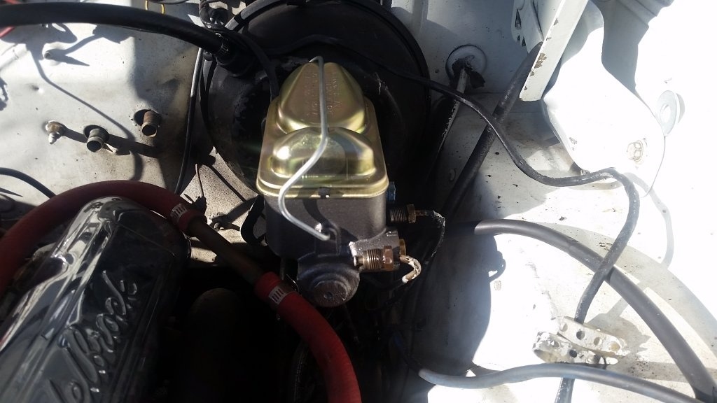

Post a picture of your MC and brake distribution block.

plugged M/C. It holds. something past that.
