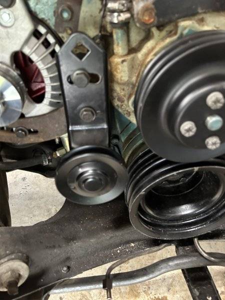

Is alternator on same belt with WP 36"? Just adding ac to my originally non AC 65 staying with only 2 belts on crank, one PS & WP and second Alt & AC I like the way your going with 3 groove crank pulley and having 3 belts. Saw some other non AC car did it this way so was easily set up and I'm going heavy duty belt on AC as only using the one groove/belt. jk
The crank pulley is 4 groove with a slightly asymmetric bolt pattern. The back 2 grooves run the Alternator and AC compressor. The water pump pulley is two groove And runs off the 2nd groove back. the WP pulley runs with the idler Which tensions the belt. The front groove on the crank pulley runs the. PS pump via the front groove of the WP pulley.
Hope something here is helpful. I’ve enjoyed figuring it out and thought I’d share with the next guy.
From the Service Manual. Ive installed a two groove pulley on the WP and the PS belt runs over it (different from the manual).
The two groove water pump pulley doesn’t work. It’s a single groove. I finally got it back together
You are also running a 69 up compressor and Mount aren’t you? Original lower mount was a cast iron piece and the compressor sat at an angle I believe. Looks nice though.
The idler bottom bolt goes through the alt bracket? I just got my idler setup in today. I’m assuming this is why my alt was at an angle and requires washers to shim it straight with the ac pulley. I already picked up a single groove for the water pump.
On a related note, will I find water when I do the idler install? It’s been many years since I’ve had those bolts out. Can’t remember if those are blind or not.
