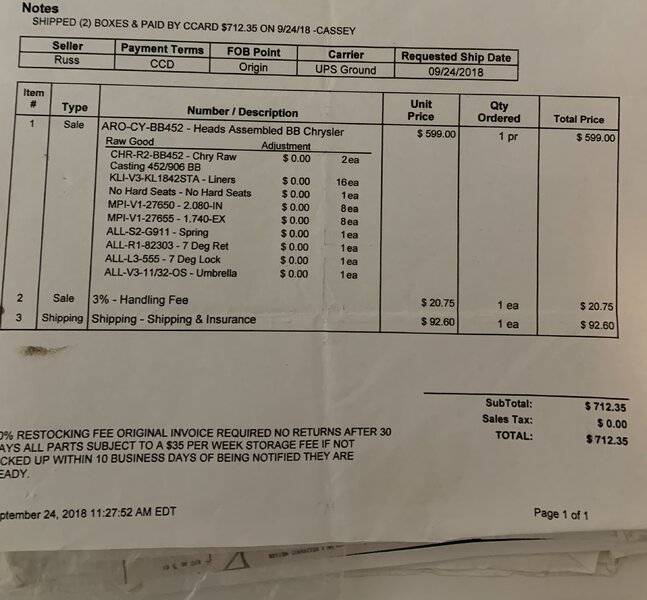

. Here is the receipt from Indy. I called them and they assembled a set of 452 heads with springs that supported the cam. Said they supported up to 0.5” lift. Don’t know anything else.
I just ordered a set of 440 source aluminum heads. Will use them with my new stock cam.
View attachment 1250729 View attachment 1250722 . Here is the receipt from Indy. I called them and they assembled a set of 452 heads with springs that supported the cam. Said they supported up to 0.5” lift. Don’t know anything else.

The “G911” spring Indy uses has been sourced from a variety of vendors over time, with the seat/open loads varying greatly between the different “versions”.
The ones I’ve had come on their heads for the last several years really wouldn’t be suitable for most HFT cams imo.
Measuring the installed height and checking the closed/open loads might be revealing as to a possible source of the problem.

The G911’s I’ve been seeing for the last several years have closed/open loads the same as a Comp 936, at the same heights they are rated at.
149@1.900/328@1.350
Better suited towards a street SFT with EDM lifters imo.
But....... through the years I have seen at least 3 different springs come on Indy heads that were designated as “G911”, which is why they should be checked........ so you know what you really have.
