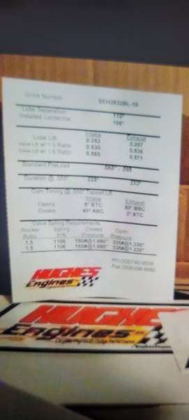

Ok ,I have 70 roadrunner 440 -6 barrel, long tube headers,906 heads ,with a Hughes cam, specs in pictures, 3:70 gears 29x18w x15 mickeys, 727 auto. I was told to match it with 3500 stall which I did but at the time my gears were 4:55 ,everything else the same. I want to be able to cruise and maybe hit the track twice a year. Will this work? What would a stock converter do ? Again 3:70 ratio now. Cam card picture sucks lobe separation 110, centerline 106, lift intake 0.530, exhaust 0.536, duration @ .050. -228. 232

Your camshaft is very similar to mine but your's is a bit less duration.

That hughs cam is pretty small. I can't imagine needing much, if any , above a stock converter.
i was just looking on the hughs site and that cam only has 10 degrees duration at .050". a stock street hemi converter would easily match up to that with a proper tune. my cam has 18 degrees at .050" with a street hemi converter and works fine. i wouldn't use a 3.70 gear either. a 3.23 or 3.55 at most would work fine. doing all this low gear/loose converter stuff just works the engine rather than letting the engine do the work. loose converters and low gears are just band-aids for no torque engines. do you have a no torque engine? i think not.
