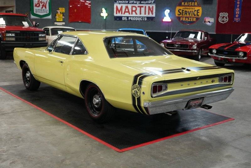

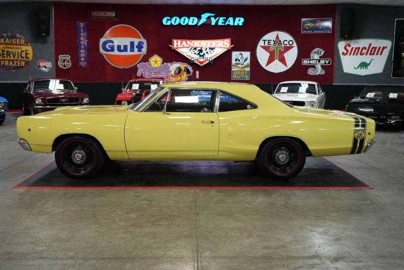

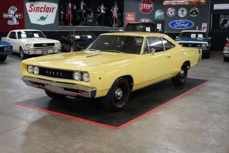

Here are 3 photos...does it sit too low?

Front looks a little high & rear an inch or two low. How old are the rear springs?

The stock ride height procedure leads to the stock body height so that’s what you use if that’s what you use if you want it to be stock look.
