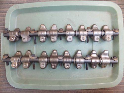

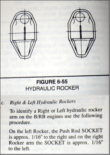

Rights and lefts...

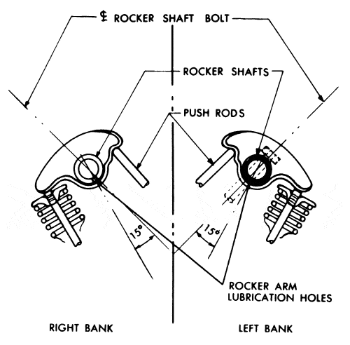

Make sure the oil holes in the shafts are pointed down and toward the valves.
Torque shaft bolts to 25 ft lbs. No more than that or you'll smash the shaft.

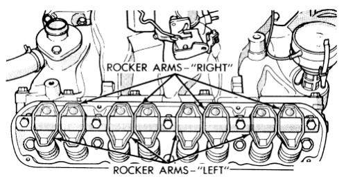

This pic shows how they're assembled. Notice the long and short bolts, also the narrow and wide hold downs.

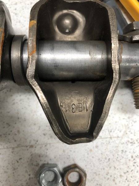

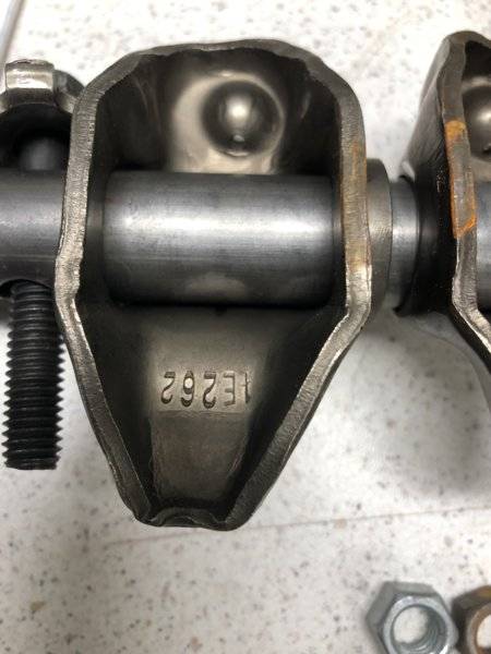

I’m about to do this too. Here is a good picture of them up close. The 314 should be a right and the 262 is a left if I read the above post right
On a side note, anyone recognize the numbers on these as to what brand they might be?? They are near new, but I got em used in a parts swap deal...

Those are factory Chrysler rocker arms
I have seen those numbers all over the place and not consistent honestly
Right and left are easy to tell based on the offset push rod socket stated in that picture 6-55

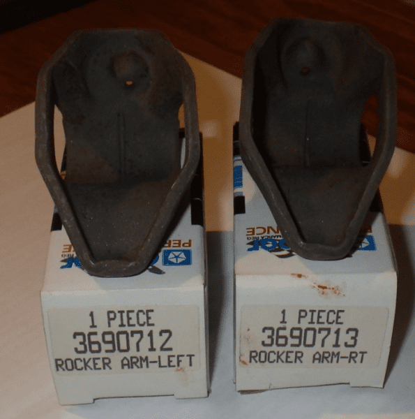

69-71 Factory Parts manual shows the same part #s L/R for all 383/440 rockers

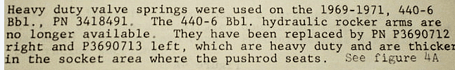

However , supposedly starting on the 69.5 A12 Sixpack the rocker arms where stamped heavier gauge steel from the factory
Around .140” Thick
Mopar Performance used to sell the heavier gauge steel along with Mancini Racing , but no more
I run Sealed Power stamped steel rocker arms and shafts on my 383/432 Stroker with E Street Heads
The measured thickness on the new Sealed Power Rockers was slightly thicker and looked more consistent then my factory original 1971 383 rockers
Sealed Power .140”/.145” Thick when I measured
Stay away from the Elgin Industries stamped rockers if buying new , I returned two sets before I found the Sealed Power parts made in the USA , night and day difference seriously

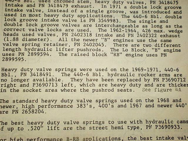

Read this from Chrysler back in da day
Thanks for the tip on Sealed Power Rocker Arms
Any source for the thicker ones today- I have not seen any in years except NOS
