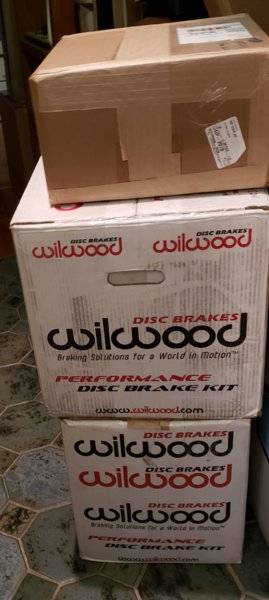

6 piston calipers on all 4 corners, 12.88 drilled, slotted front discs, 12.19 drilled, slotted rear discs, w/parking brake drum.
Installation coming soon.
