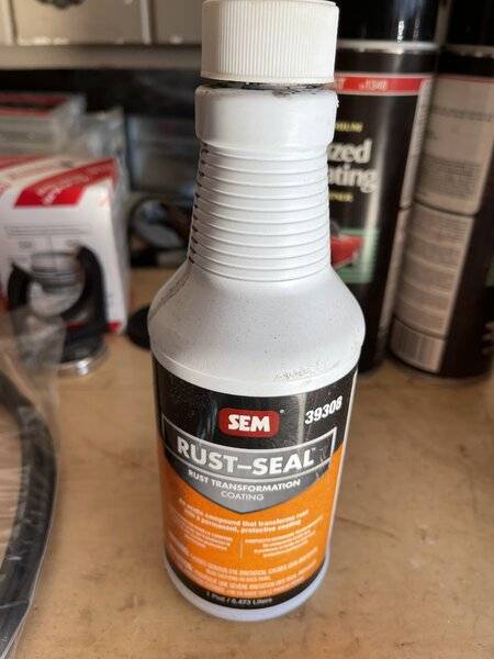

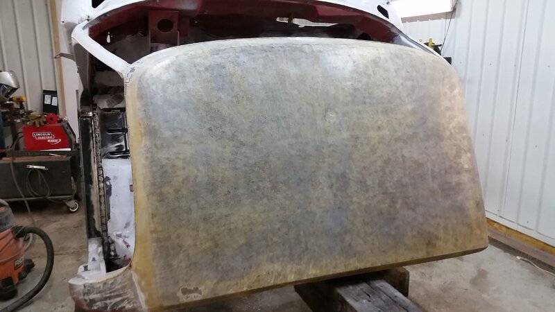

I don't see SEM in there? I used their cleaner/converter on a rusty truck roof.. time will tell but it looked like it worked.
This was solid rust, I removed everything I could then treated it.
