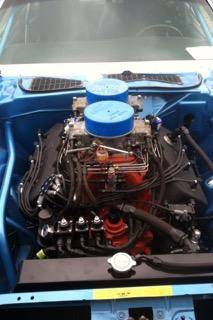

We pretty much had to overcome all the things mentioned to make a low deck 542. The only thing I would mention is the 7.4" rb counterbalances will fit in a b if you want to grind and make it fit. But, I certainly don't recommend it. Our low deck 542 is built in the spirit of F.A.S.T. racing, not really maximizing anything other then displacement and our open chamber iron heads flow 320cfm. No roll bar... so faster then 11.5 et they will send us home. Hoping to get there with 3.23s. Not going to set any records, but should be a fun stock appearing '72 satellite sebring hiding a 542.
