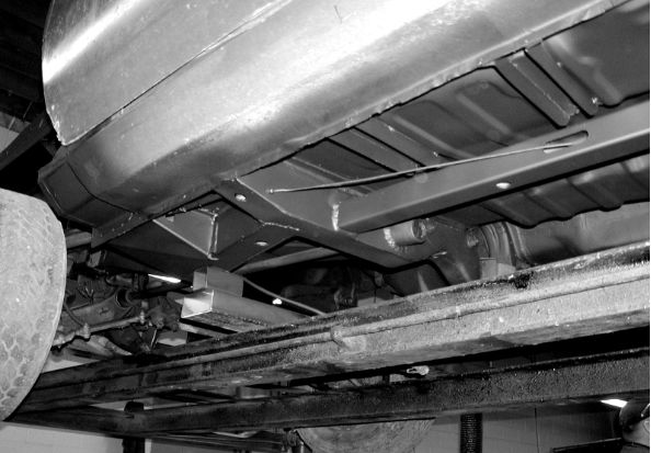

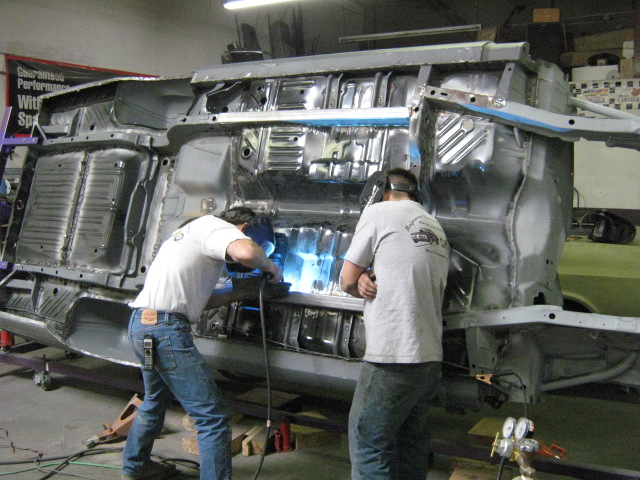

As for installation, I measured and leveled everything, cut the floor where the connectors were going to be installed, verified that nothing moved, then put in 2x3 tubing.
I installed the U.S cartool kit SFC/torque boxes/inner fender braces/moved springs in as well and the lower rad support, really nice kit a little tweeking here and there but overall really nice fit. I am sure it will be a lot stiffer now. I also welded up a lot of seams while I had the chance. thx Bruce
Great pics, I have a question, you moved the springs in, can you fit a 3" exhaust and the stock fuel tank? How big of a tire can you fit with the springs moved?

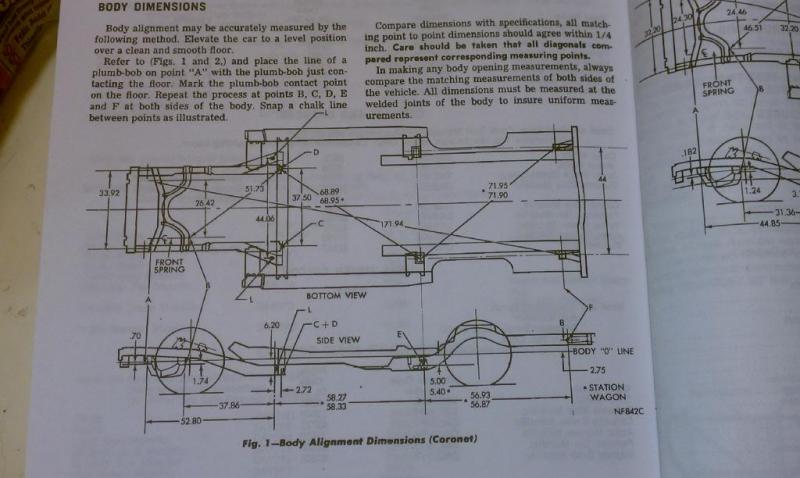

I welded my uscartool connectors everywhere they could be welded after insuring my chassis was straight with mucho measurements, plumb-bobs, lasers, and a lot of sharpie marks on my garage floor. I also connected them into my roll bar system which goes from shock towers to rear-end hump, kinda like bridge girders. Here's the factory spec drawing incase anyone needs it.
