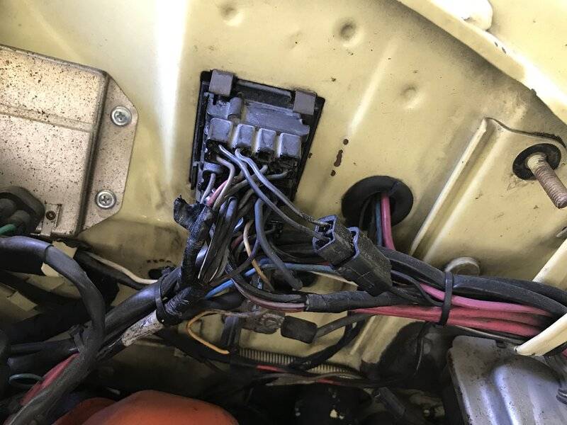

Sounds like a typical charge circuit Packard terminal failure in the bulkhead connection. Weakest link in the original design, always has been. Bypass the bulkhead connections for those two runs.

Does it have a Bulkhead connector?

As I posted earlier, my power gone gremlin was the ignition wire at the BH. It was a bee-itch trying to trace it down; but in my case it had an ignition run syndrome - car would start/run only with the key in start mode. Often this is either a BR or bad key switch that I ruled out. A bud went around gently moving wiring around and when he tipped the BH harness up car started. When inspecting the connections look for any indication of overheating sometimes not readily noticed until looking closer. At least for me having old eyes...so if it might be the ignition wire, the run only in start mode could be a clue.

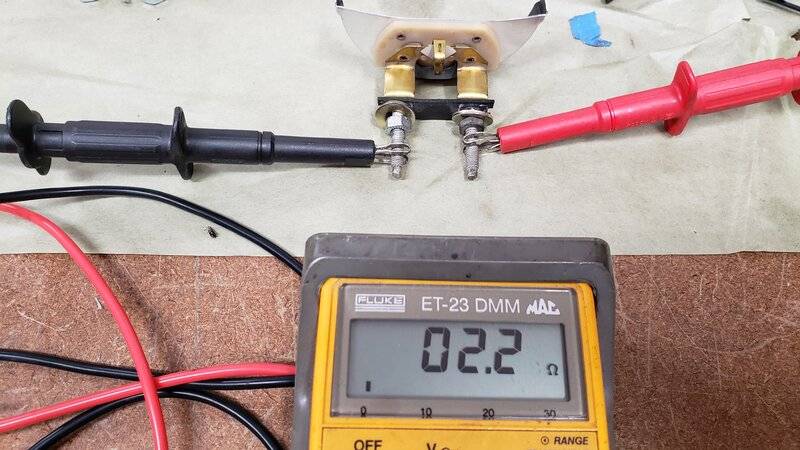

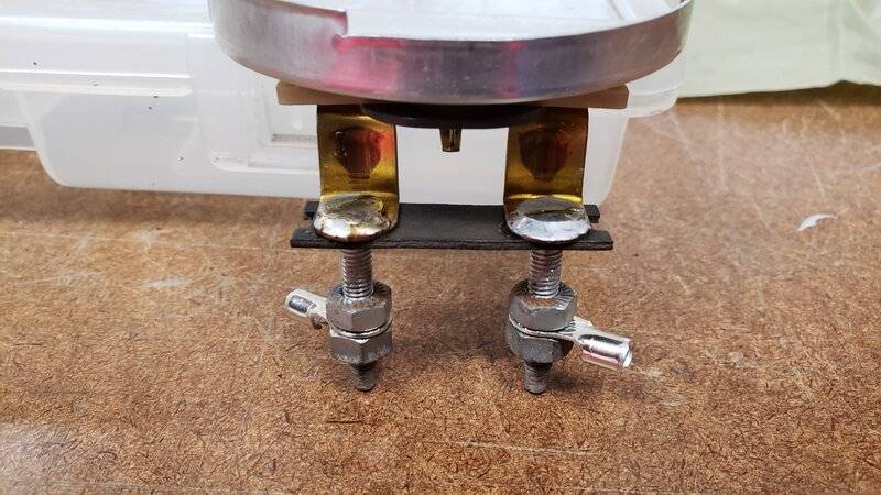

A few weeks ago I was troubleshooting my ignition just randomly shutting off just like I turned the key off! I had done all the above mentioned steps with no firm results. So I started tracing power from battery, trough bulkhead connector and when I got to back of amp gauge both nuts were tight, but I was getting 12.34 volts on one side and 10.1 on the other, so I unbolted the two wires from gauge and bolted them together, just like magic it's been a few weeks and no cutting off. I ordered an aftermarket volt gauge to add to my aftermarket gauge cluster mounted under dash which holds oil pressure and temp gauge. That's my fix, obviously I could get a new amp gauge for stock gauge cluster. WARNING, heavily tape your bolted splice until you do proper splice connection.

Sounds like excessive stud head to bus resistance. Double nut to the ring terminal may have been tight, mounting nut likely loosened up, or insulator failed from heat/resistance build up. Either way, pretty easy fix if the bus is not too distorted/heat damaged.
