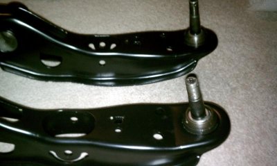

Installing ball joints today, uppers, K772's went fine. Installing the lowers, K719's and one was able to be torqued, the other, not so good luck.
What can i do here? I dont want to have it welded in.
Does anyone have a set with good threads they would like to get rid of?
Are there aftermarket lowers available?
This really blows!!!

My problem, the lower control arm is so bad that i can just push the ball joint in, and the threads dont grab at all, so i would like to avoid welding it.

Yeeeeeeeeeeeeeeaaaaaaaaaaaaaaaaaahhhhhhhhhhh!!!! Success!!!! The replacement set i got worked out and after de-rusting and powder coating, the ball joints went in successfully and torqued to spec!!!!
