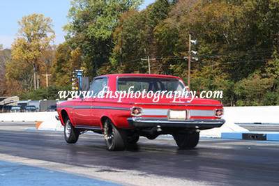

I have been more then happy with my 9.5 Dynamic converter. Its their street/strip converter and it works great. It drives like a normal converter on the street but flashes about 4200 at the track. Good enough for my 3700 lb 63 to pull a 1.50 sixty thru the full exh running pump and hitting 10.70's so far. I also drive it the 45 miles to the track. I have also used Turbo Action which was also a top notch converter. I hope yours works out good for you. Ron
