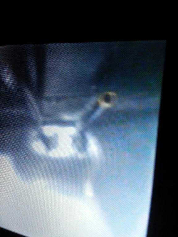

Here is the inside of my tank, the vent tube on the right was connected to the short vent tube outside which didn't make any sense when parked down hill with a full tank. Left one tied to the long tube through the trunk, I have switched these which has helped out some, now I have a filter on the long tube. it helps and has cut sown the smell dramatically most likely like you guys have said bowl vents. Even that is subdued by the factory un silenced air cleaner.
Wondering if the tubes in this tank are backwards, it was changed some time in the early 90's

My cap is a year or two old so rubber is good it is a non vented cap, I will look a t a replacement this weekend just for the hell of it maybe that it? don't hear any gurgling though.

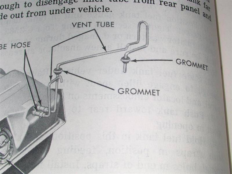

Always wondered why there were 2 vent tubes. I know 1 is at the top of the tank on the inside. This is to vent vapor to the outside. It ends up at the top of the wheel well I believe. The other one extends down to the bottom of the tank. Then it ends up venting near the top of the tank? After going up, over, then it points down at the end. I suppose they both allow air into the tank as fuel is pumped into the carb. I heard mine gurgling before, after a hard run. Turns out the vent tube was plugged, so the air was going in thru the submerged tube, causing a gurgling sound. Guess thats why there are 2 tubes.
