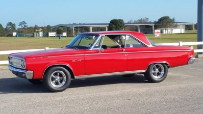

I have the 3400 hundred lb Super Stock springs on my car in this pic that I bought from Mancini. The car actually sat about a 1/2" lower and I rased it the 1/2 for this stance that I like. Ron
Did you raise it after installing the springs or did the springs provide the lift? Yours has a nice stance
64 Belvedere: I should have mentioned in my first post that I also had just installed
3400's in my '63 Belvedere, and again the stance is perfect for me. Sits just about
the same as 383man's car.
I actually raised mine about a 1/2" after putting the 3400 lb SS springs on. The car sat about level and I used a slightly longer shackle to raise it about a 1/2" to sit like this as I like a tiny rake to it. Thanks for the kind words. Ron

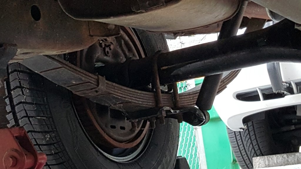

Excuse me for jumping in here......but these springs were on my 62 Belvedere when I drug it home. It has an newer 8.75
As well.
Are these SS springs?
As well.
Possibly. Correct right side springs will have 2 half leafs on the bottom of the stack. Yours looks like 6 leafs. But some people use 2 left side springs so it doesn't sit crooked. SS springs should also have a number stamped into the spring on the bottom side.
