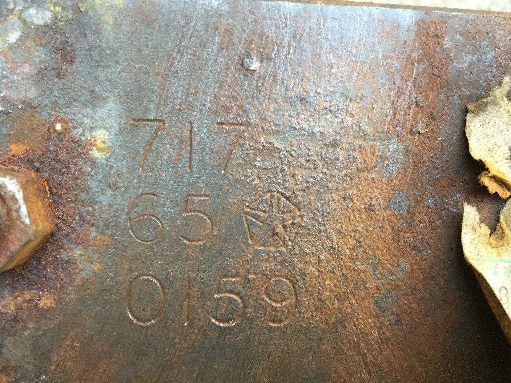

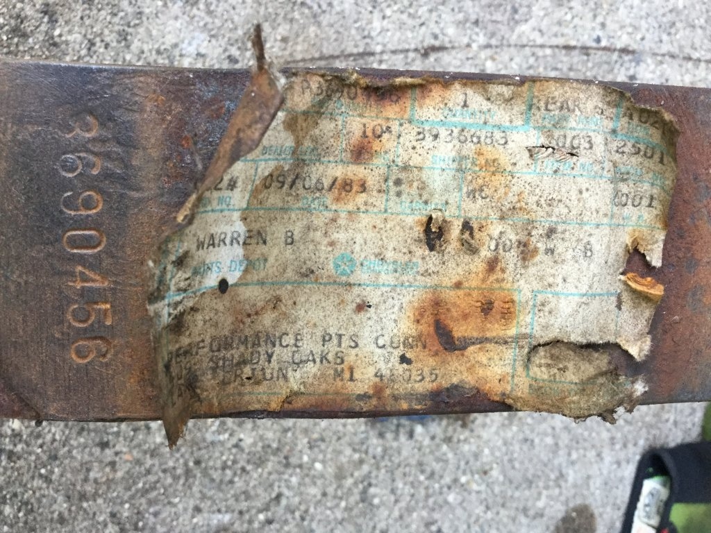

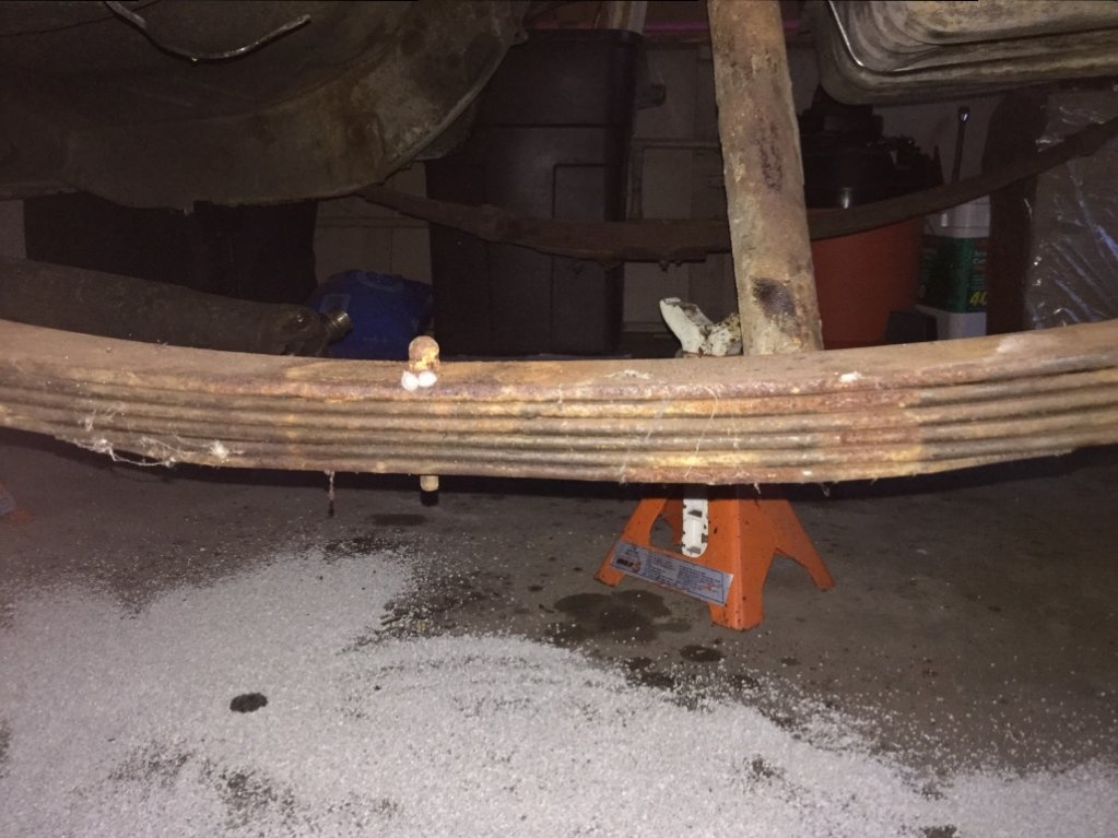

I bought this 65 Coronet a couple years ago and my brother told me it had SS springs in it. I just pulled the rear out over the weekend. He is going to narrow it an inch per side to fit the rims and tires in and put all new drums on the rear. I pulled the left side spring off today and cleaned it up. Here are the numbers I found stamped on. Maybe it'll help someone. I'll try to get the right side off and cleaned up and post any numbers from it in the next few days.

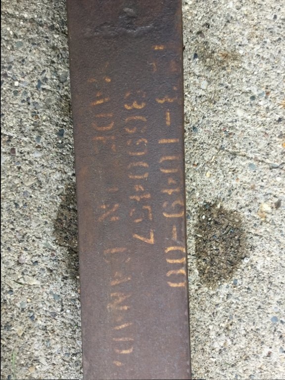

Here are the right side numbers. I can't believe that label is still on there.
Yep, those are super stock springs. 3400lb, 456 / 457 set.
