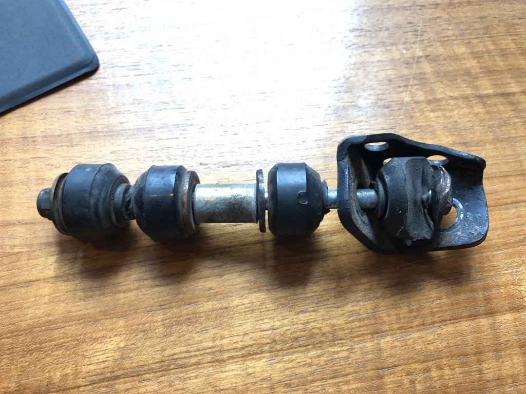

It looks like the drop end links will work with my sway bar/shock mount location. I remembered that I had these ugly things and did a rough mock up of the spacing.
Then I ordered a set of energy suspension end links off Amazon for $20. If that doesn't work then I will switch over to a Hotchkis Sway bar as that seems to be the most economical fix.

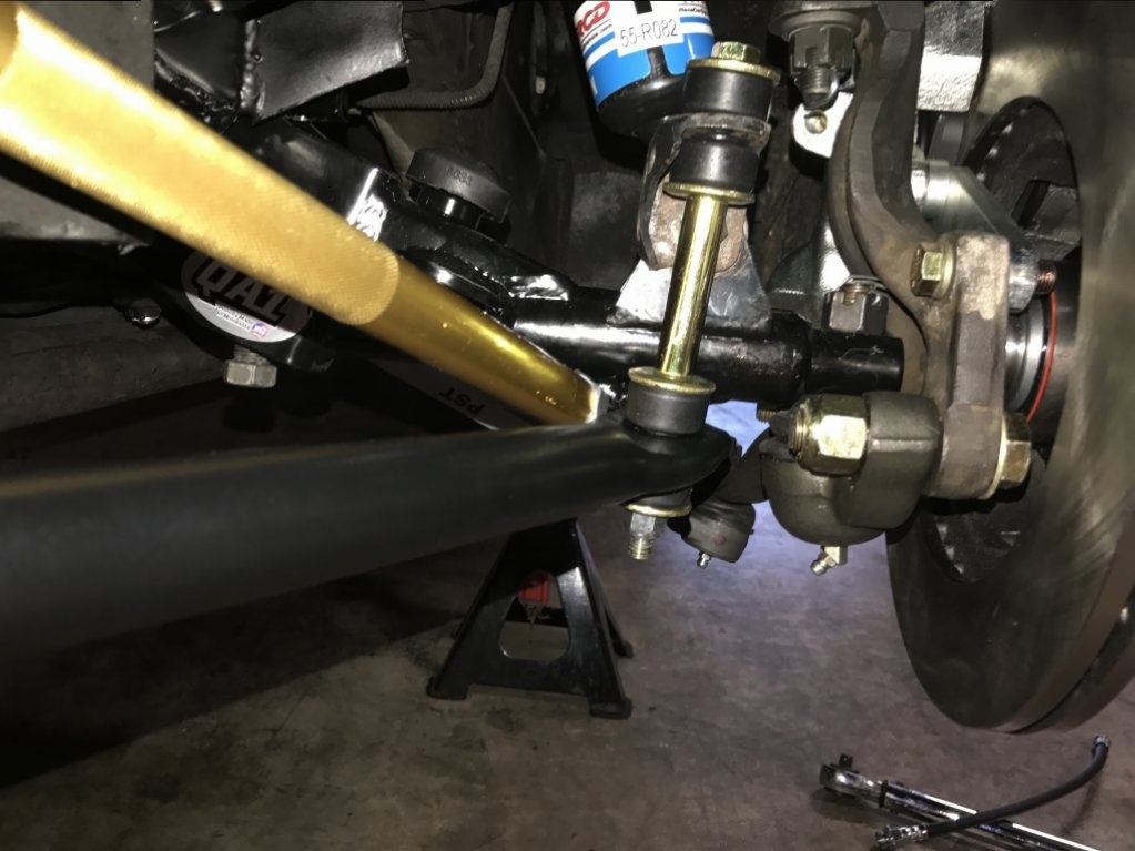

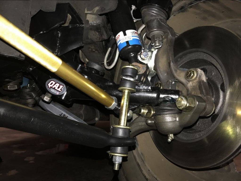

Ok. Update. I mocked up the sway bar using energy end links. It looks very close to the nut on the strut. Not sure how close is too close. Also, this is in the air so not sure how the geometry will change when it's sitting on all fours.

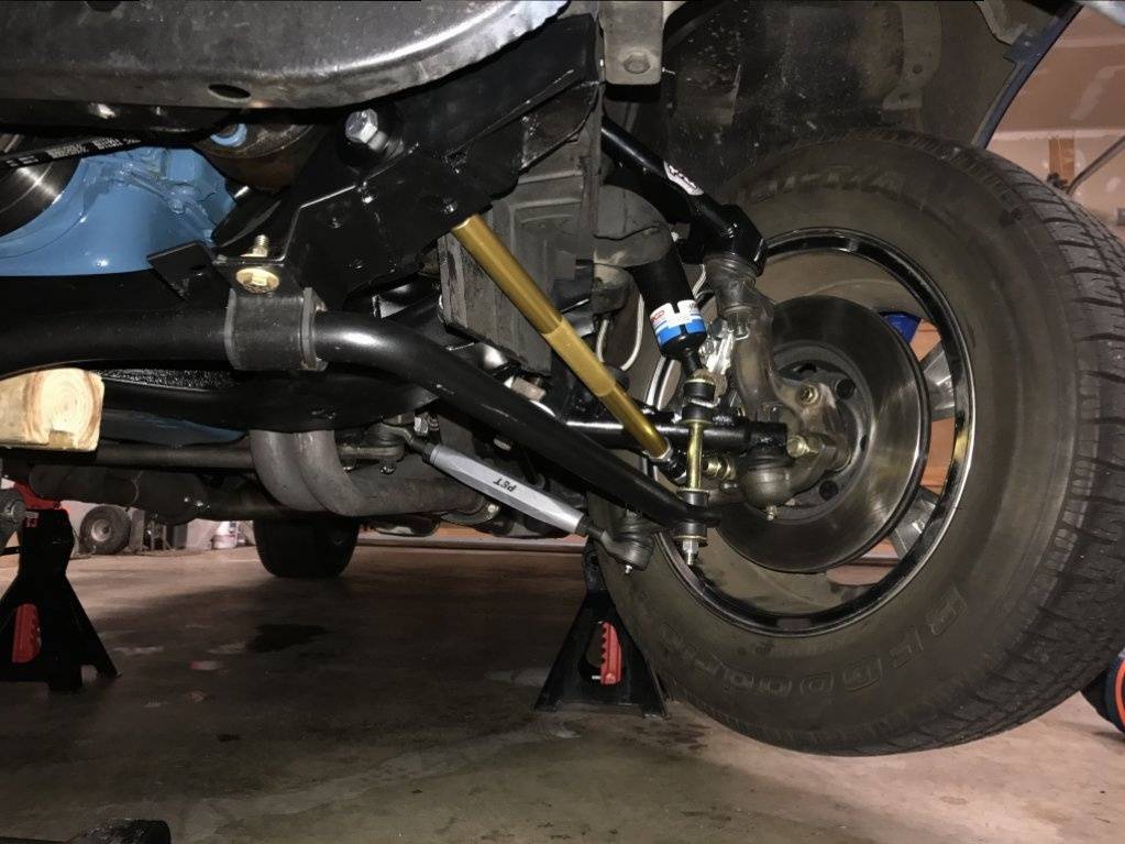

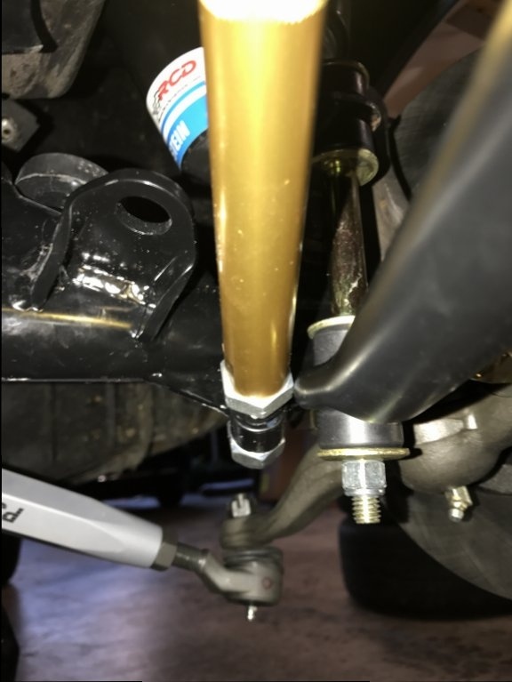

I wanted to put a top on the thread. I was able to use my stock sway bar and the QA1 lowers by mounting the sway to the shock bolt and using Energy Suspension end links, #9.8118g.
Barely clears the strut nut but it is fine.
I had it professionally aligned and toughened. Everything handles awesome now.
