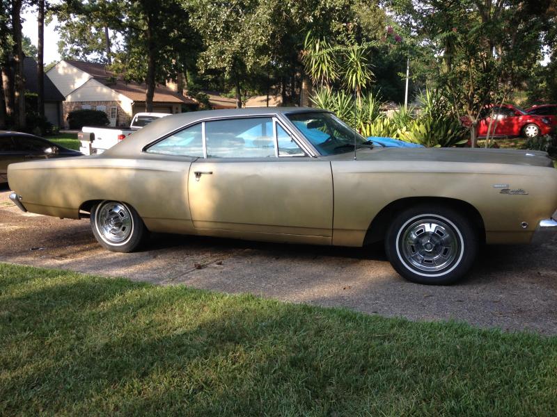

okay my new 68 Satellite Sport runs nice....however I'm not waiting long to improve the suspension. Its 48 years old and floats like a butterfly going down the road. I would like a stance where the car is sitting UP a little with a forward rake ( old school term for front down a little more and back up) but not HIGH JACKER style.
What are the conditions and then what are the solutions outside of standard replace springs and leafs?

Okay, some minor changes made, the rear is in good order now, last night I lowered the front and I love the look of these cars with that rake like that yeller one up top.
