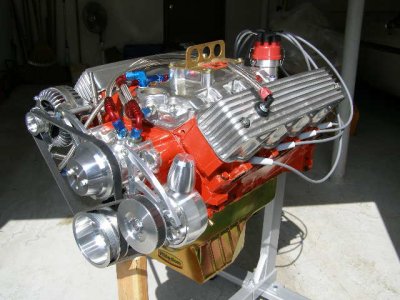

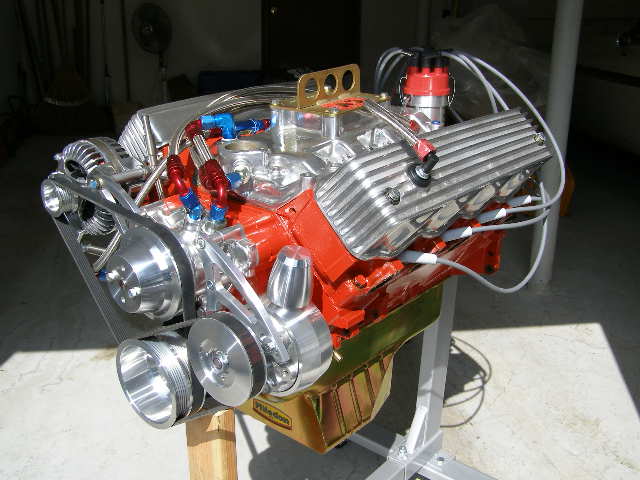

You beat me out of another worthless Poly for my collection...
What year car. The swap is easy in a 66 Belvedere I know...need to swap out the driver's side motor mount bracket because the 360 uses a different one. I think the trans even bolt up but the 360 is externally balanced and the teen isn't so the torque converter is weighted for the 60.
Fury, that's a nice looking engine!
