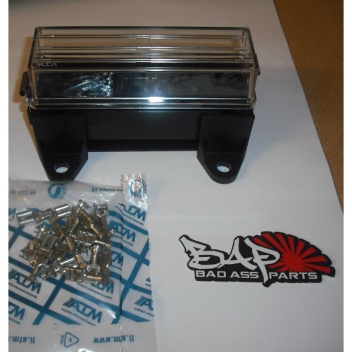

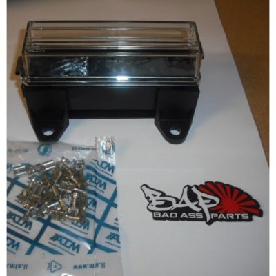

Slow progress here, ordered a set of sealed beam conversions and also a pretty nifty relay holder

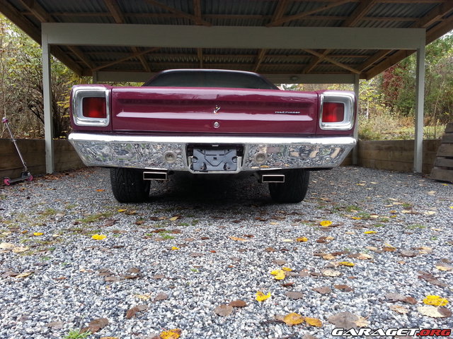

Sharp looking car! Good luck with your upgrades. Interesting that is has GTX/Sport Satellite Tail Light's. Never the less, pretty dang nice, wheels look great with that color combo.

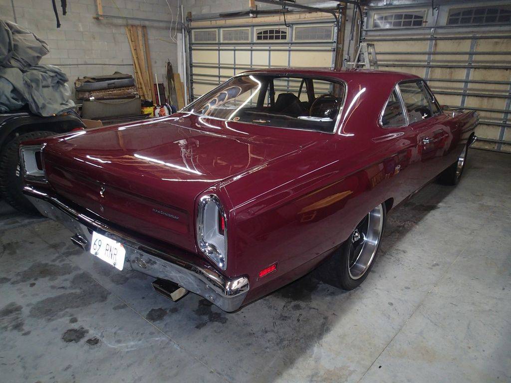

Hmm, as a complete newbie on b-bodies - it does? How to tell? Here's a better picture of the rear

After some google image search - it seems apparent that I have the GTX tail lights... Dunno why they put that on. I fear that the paint under the bezel don't look that good so I'll wait until respray to fit correct lights on it.
And another shot that shows the tail

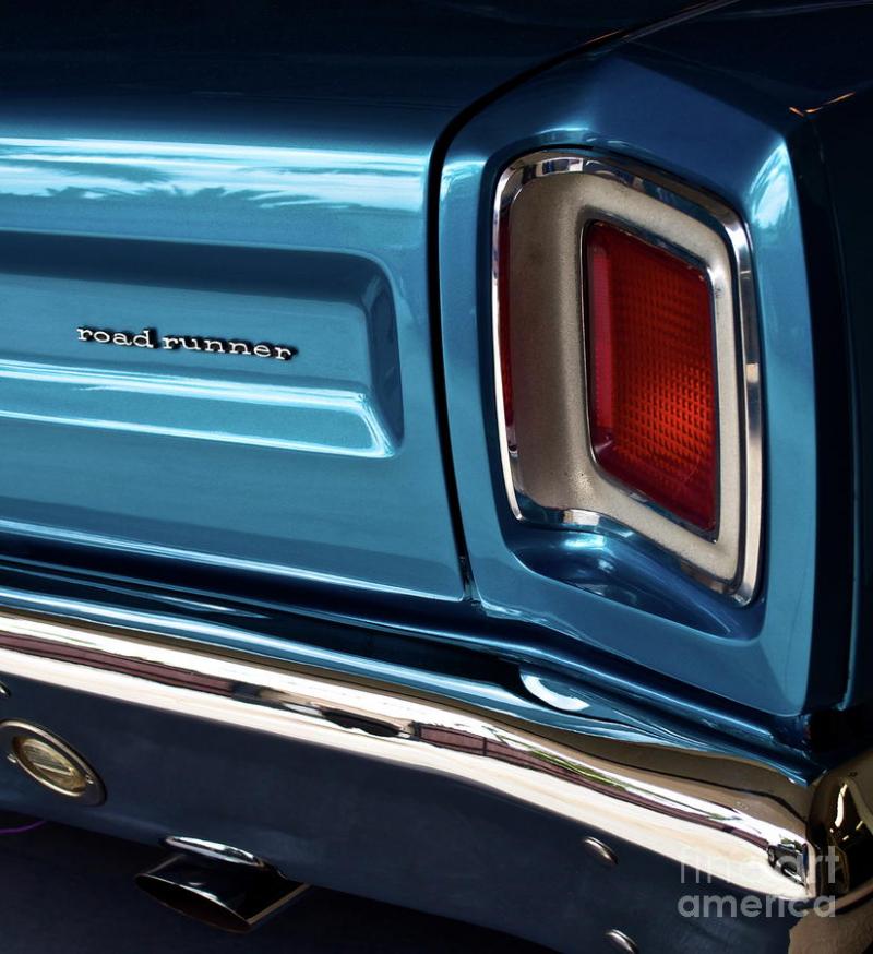

Here's a roadrunner tail light housing. The buckets are not as deep as the GTX/Sport Satellite.
Yours look like they're in excellent shape. I would imagine you could easily sell/trade those, if you wanted to go with the roadrunner style. Like mentioned, car looks great either way.
They are in excellent shape, small chrome loss on one on the inside, maybe 1/3 x 1/16 of an inch along the inner side of them.
I will put them up for sale when it's time for respray because I don't know what the paint look under the bezel. So you think they are possible to sell or trade?
Oh Definitely! Those are more rare than the standard satellite or roadrunner housing's/lens's, and yours are in excellent shape. Good news is that decent set of road runner tail light's are not very hard to find. You can also buy them brand new if you want. Several places sell them.
Then it all comes down to what the paint looks like under the bezels. Thanks for the heads up though! I wouldn't have caught that myself ;)
Question though, when I look at yearone repros of the RR tail lights it states that they don't fit the GTX body - but they are interchangeable the other way around - or has there been work done to the body as well you think?
Hey no problem! The lenses and the tail light bezel's are different between the GTX and Roadrunner. The quarter panel extensions that the lights are housed in are the same between the two. If converting back to the roadrunner style you will need both the bezel's and lenses.

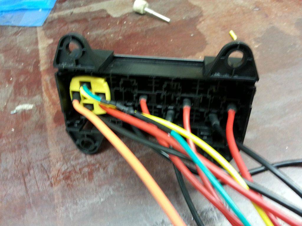

Also started building a relay harness with a relay box today

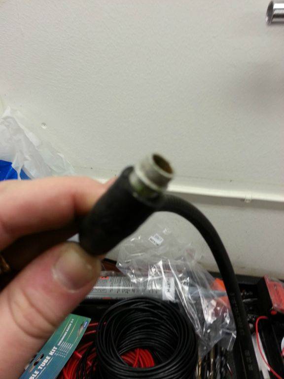

And when removing the ugly faked steel covered hose from the radiator of course this happened

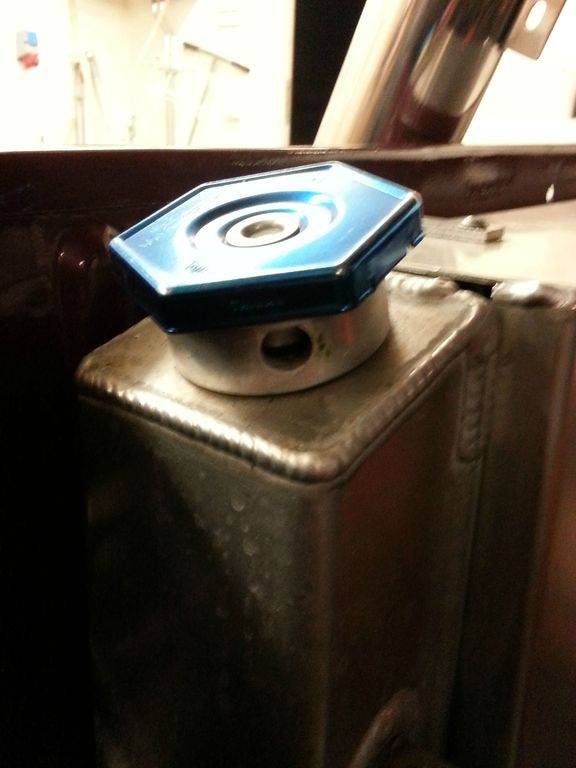

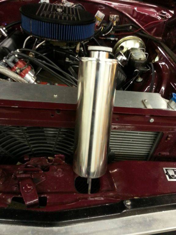

Last - Summit racing delivered an expansion tank for the coolant and a new check valve for brake booster (where the valve was a) wrong size b) made of cheap plastic and c) leaking)
Question: The bulkhead connectors were lost sometime back in the days when they re-did the wires. Now there's individual cables to each headlight, probably to keep current drop down, but no relays. I've added relay harness (above) so question is what to do with the second cable? I could either cut it at firewall and then just run one cable to low beam relay and one cable to high beam relay or run both and connect them both to the relay. What would you do?
