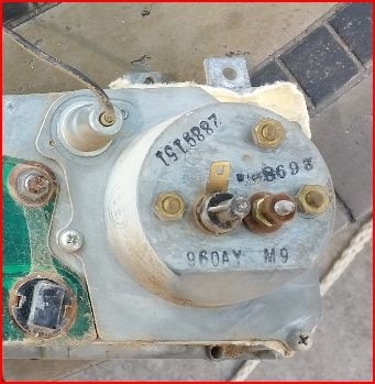

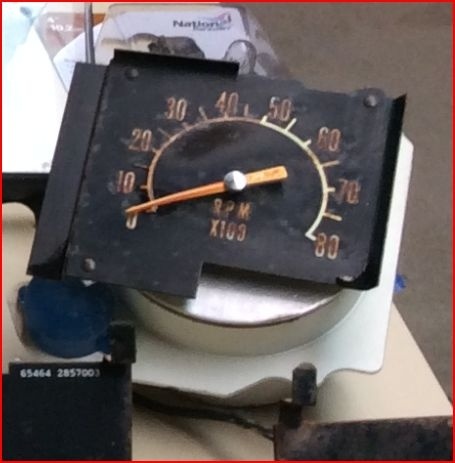

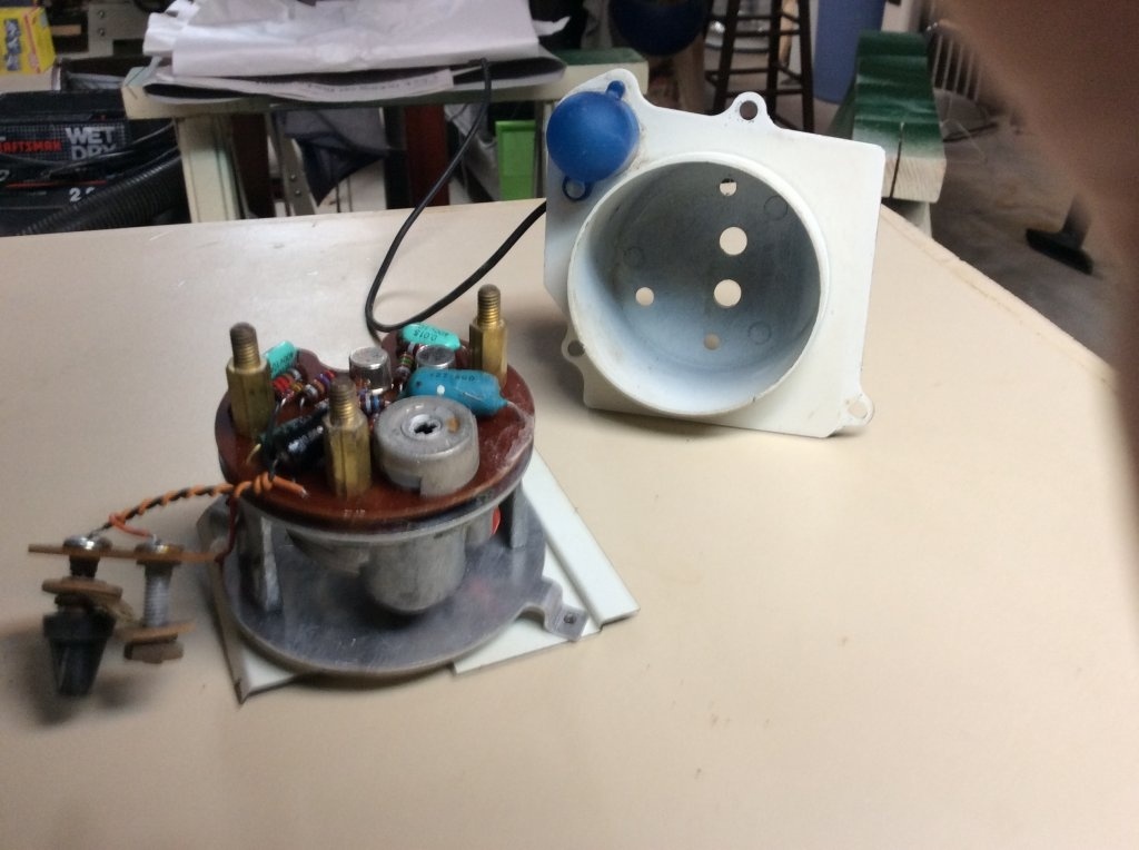

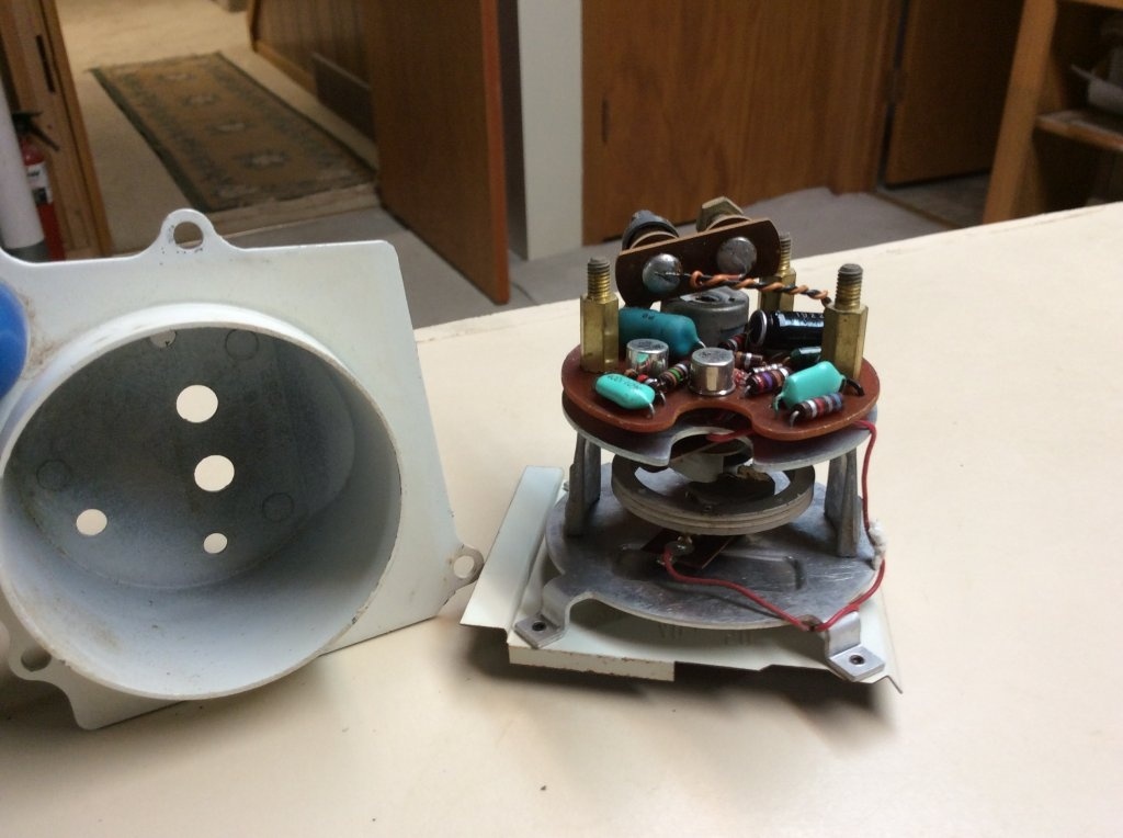

So I appear to have a good tach out of my donor dash except for the face which is tacky.
Any thoughts on techniques / resources / vendors to help restore or replace the face?
How are the needles removed without trashing things?

no back support required to pull the needle off? Worried about trashing the movement!
OK, I found a solution. NOS tach gauge face!
Use a kitchen fork to remove the needle it works like a charm. To replace the face plate you need the brass semi tubular rivets and a tool to squeeze them. You would be better off with the decal they are spot on for fit and finish. If you go with replacement the link above, they have the correct rivets.

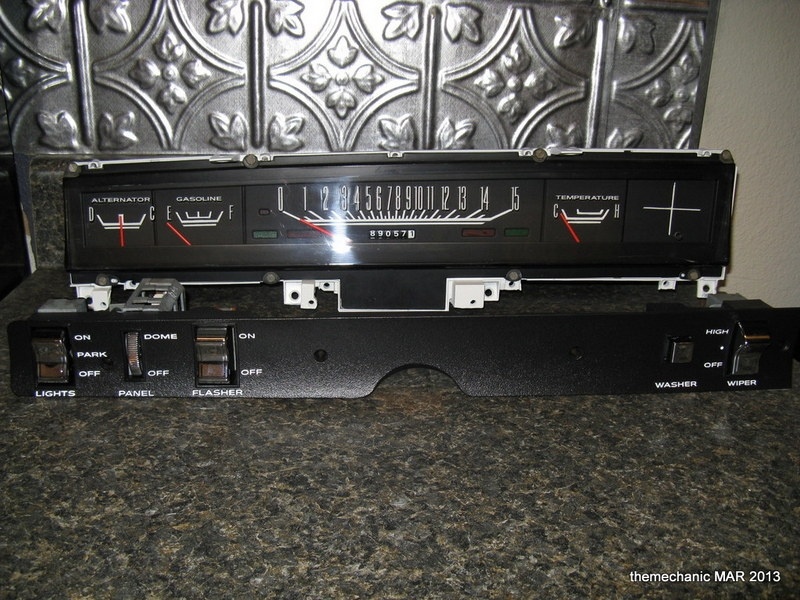

I used the stencils to repaint my 69 Coronet standard dash. Pull that needle off, strip the face, prime and paint. Use the stencil and repaint the white. Paint the needle and push back on. Judge for yourself.
