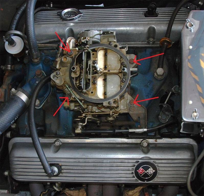

Hey guys;let's cut Dom some slack-we all had to learn at some point. I've got the same unit that Daredevil posted a pic of on my '90 Chev truck. Dom;get a GOOD penetrating oil and spray any fittings that need to be removed. Everything is dis-similar metals and can get pretty well oxidized and corroded. DON'T force anything in removal,and like Benno said-take photos! In my early years,I made drawings or took pics to avoid mistakes on reassembly. Use anti-seize on any fitting threads and even the holding nuts/bolts. Good Luck!
