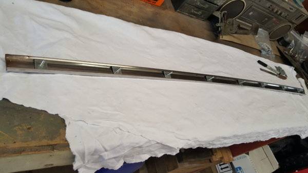

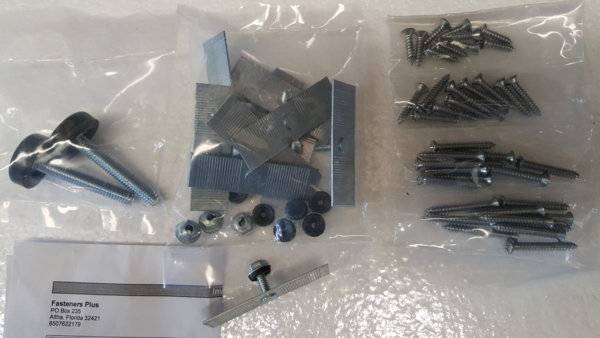

Received the "fits all" trim clips today. The original ones were just too far gone to reuse. Thought I would try these instead of hunting all over the place.

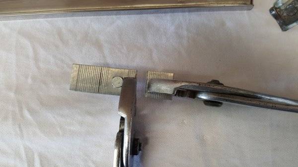

Just mark them, take your pliers and break them off. It takes a little effort.
I rounded the corners so they won't dent the edge of the trim when you tighten them down.

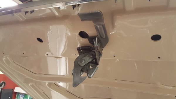

Cleaned up the latch mechanism. Still has good galvinizing on it.
Installed the hood adjustment bumpers and we're good to go.

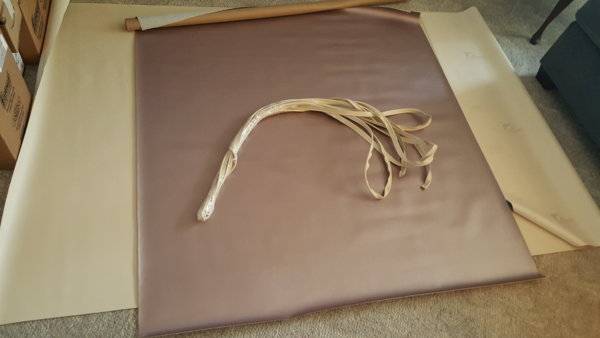

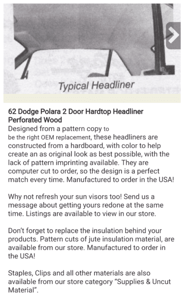

Ordered a board headliner from Collectorsautosupply. They are made by REM. I contacted REM and they sent me some actual pictures of the board. They were a bit more in price so I ordered it from Collectors.
https://www.ebay.com/i/192364626869...3D711-117182-37290-0%26rvr_id%3D1377263008318
Actual pictures of the headliner.
Here's a thread that @MW 413 started. It should resemble his.
http://www.forbbodiesonly.com/moparforum/threads/hard-board-headliner.141612/

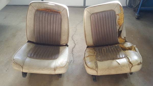

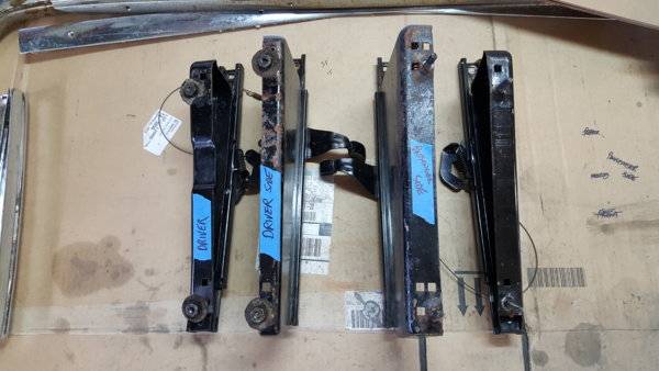

Talked to a local upholstery guy that I've known for awhile. I'm going to take my seats to him to discuss just what we need to do to get the right material and carpet. He said once he has the material he could start on them the first of January.
The driver side is the worst but we have some good patterns. Them seats are heavy!

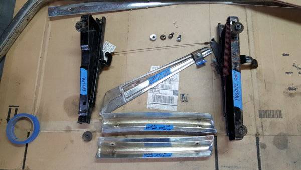

Removed all of the trim and hardware. The seat tracks are different between the two.

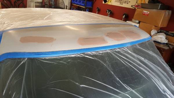

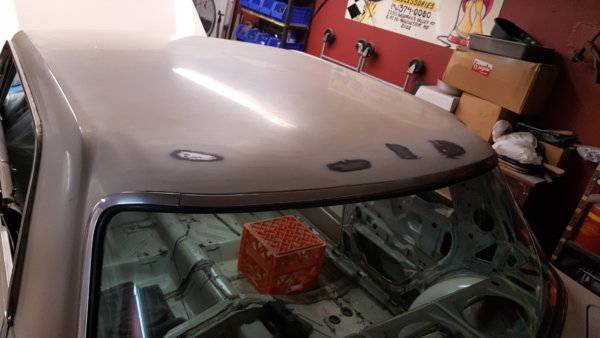

We had some above normal weather, 1st week in January. With the headliner out, I had to fix some dents at the rear of the roof. Looked like someone stacked some 2x4s on top at one time.
Useing a small bottle jack and a lenth of 2x2, I jacked them out. Turned out fairly well.

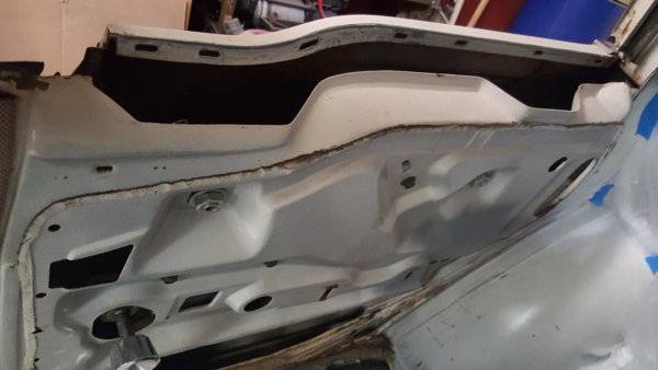

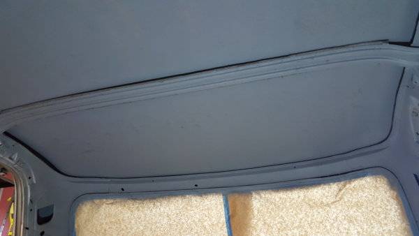

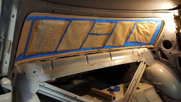

I have spent some time scraping and sanding inside the roof of the car. Yesterday it got up to the mid 40's so I moved the car outside in order to paint what I had prepped. Moved it back in and cranked up the heat.

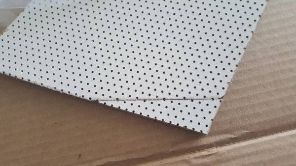

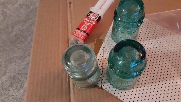

When it was too cold to get the shop heated I did some work on the headliner on the dining room table. Glueing the missing corners on, I did use some flat white filler in the seam but didn't take a pic yet. With the upholstery and the trim on both sides, just a little bit will show

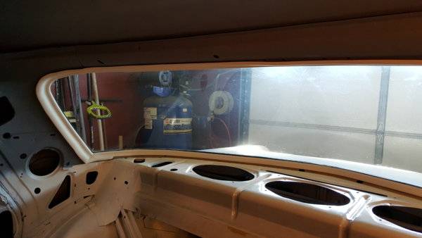

Warming up in the shop I sanded, prepped and painted the rear glass seal. (Hard on the knees!)

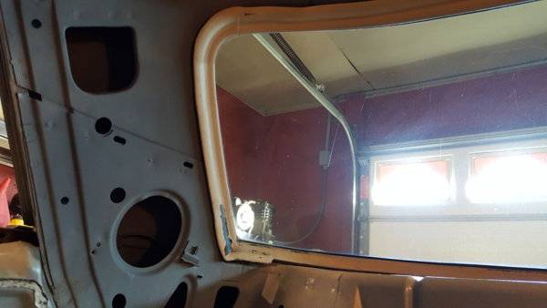

I removed the quarter windows, (two nuts and lift out) to clean the inside of that area and lube up the regulators. The edge where the wiskers go need a little primer and paint too before installing them.
Also the outer fender edges were dented with a bumper from another vehicle at some time, both sides. Had a crowbar in there and couldn't quite get it, so the old sliding hammer had to do. Weld the holes shut and a skim coat.
Did you glue corners to headliner laying on cardboard? If it stuck the way to prevent it from sticking is to put a piece of waxed paper between headliner and cardboard.

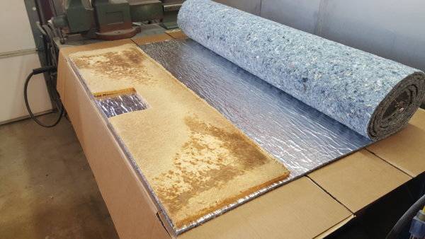

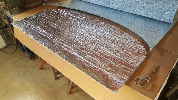

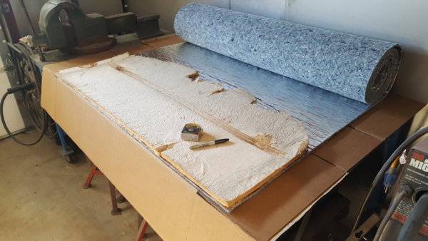

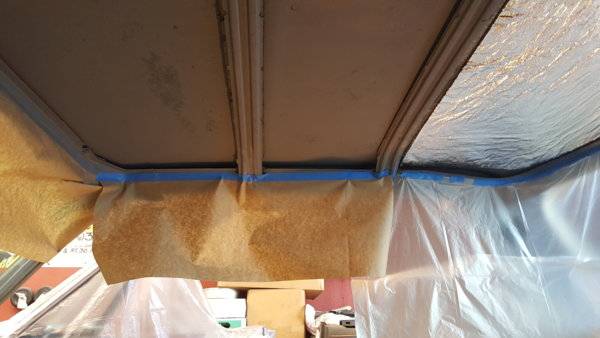

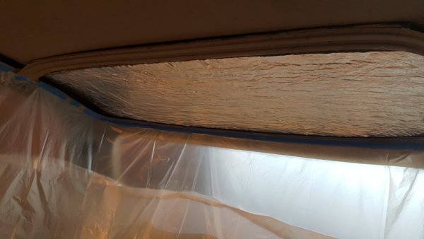

Today got up to 70* so I took advantage of the heat and installed the insulation that I ordered from Home Depot.
Taped up some plastic to keep any accidents from happening.
https://www.homedepot.com/p/UltraTouch-48-in-x-6-ft-Radiant-Barrier-30000-11406/100656748
Damn stuff really sticks. I marked center on the roof and on each piece to line it up when installing. You only get one shot at it. Turned out ok.
Tomorrow I'll get back on the quarters and get that painting done before installing any headliner board.
I used a piece of non corrugated, thin but strong cardboard for a backer to join the two pieces. Used a clear two part epoxy to knit all three pieces together. I coated both sides of every piece. Luckily nothing oozed out on the cardboard.

I think it’s kind of interesting that your package tray area has 3 speaker holes. My 63, 64, and 65 Plymouths all have only 1 speaker hole in the center. This from an era that only mono radios were offered. I would guess that it would have been the late 60’s before Chrysler offered stereo radios.

The package tray also has what appears to be a long slot for a defroster.
