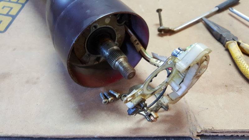

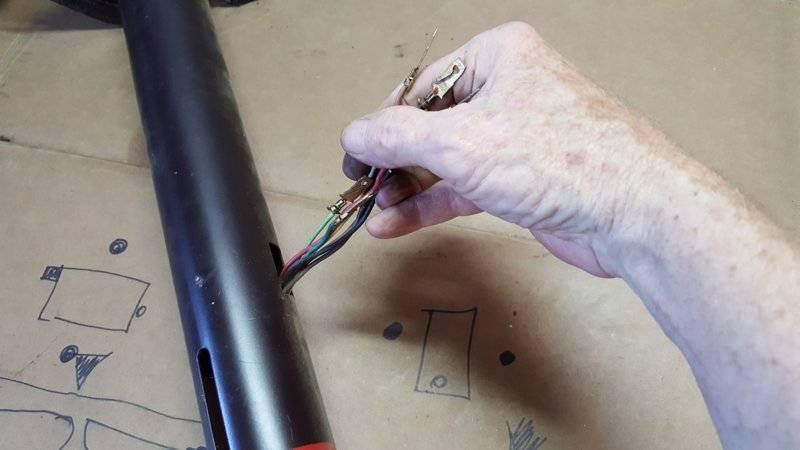

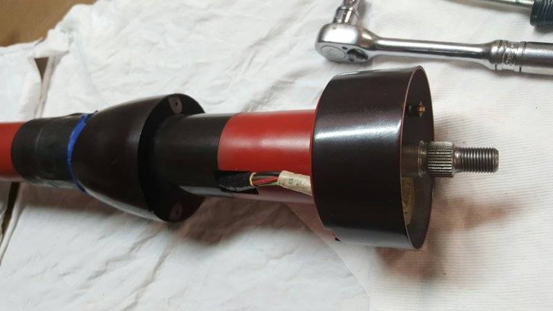

Great thread. i am working on a 62 plymouth SF and this has been very helpful. Right now I have the steering column out and I see you have a picture of yours all apart. How did you get the wires out of the cupling? I have an extra thought i could just destroy the one on it and use the extra. thought I would ask first.

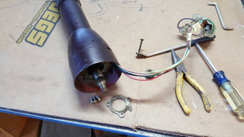

Hey Derv, glad you're finding some good info on here. Dont cut them, I guess I could have went into more detail on the steering column. Here's the page in this thread.
https://www.forbbodiesonly.com/moparforum/threads/taking-up-new-residence.114133/page-10

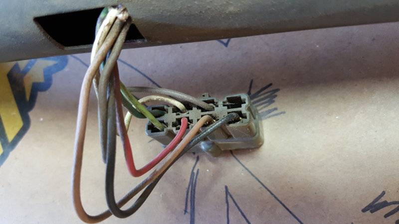

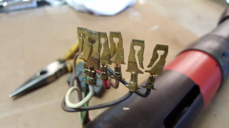

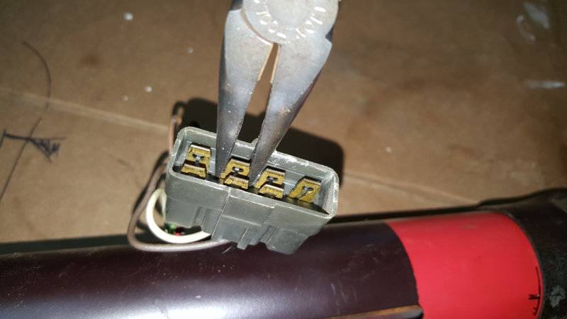

To remove the wires you need to remove the wires from the plug first. Take a piece of paper and draw a diagram of the plug, then write what color wire goes where before removing. Your FSM has this info but making note of their placement yourself is easier.
Use a needle nose plier and gently queeze the spade and push it out the back of the plug. (When installing them you can open them up a little so they fit tight)

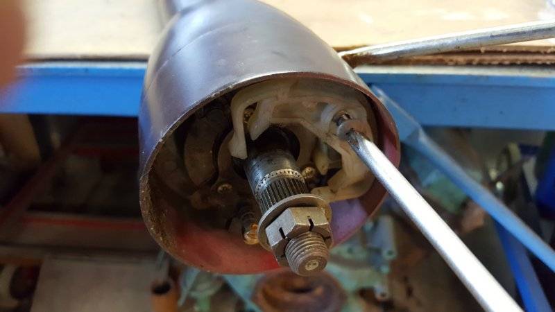

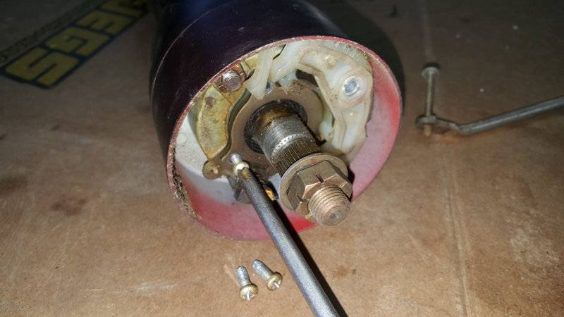

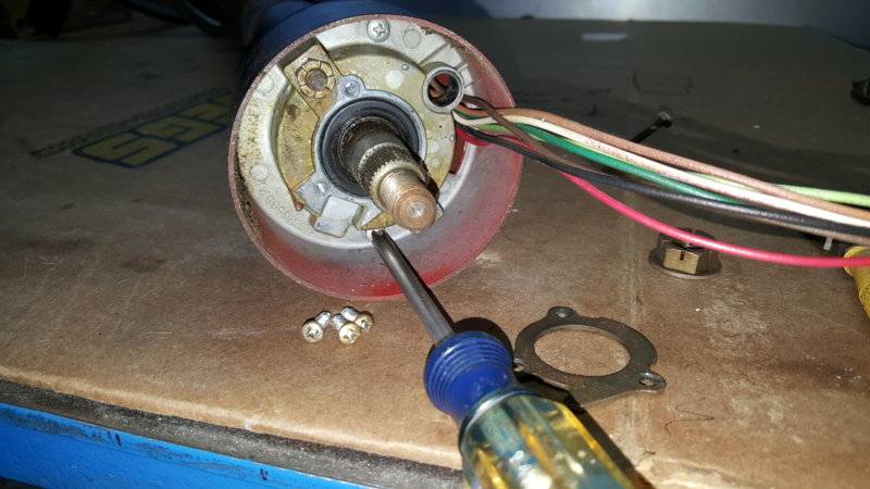

Remove the turn signal switch
Three screws

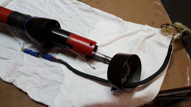

Now you can help feed the wires through the hole in the side and pull them up though the tube.
If you want you can seperate the "cup" from the column to expose the top hole for easier access.
Great, need anything else feel free to ask.

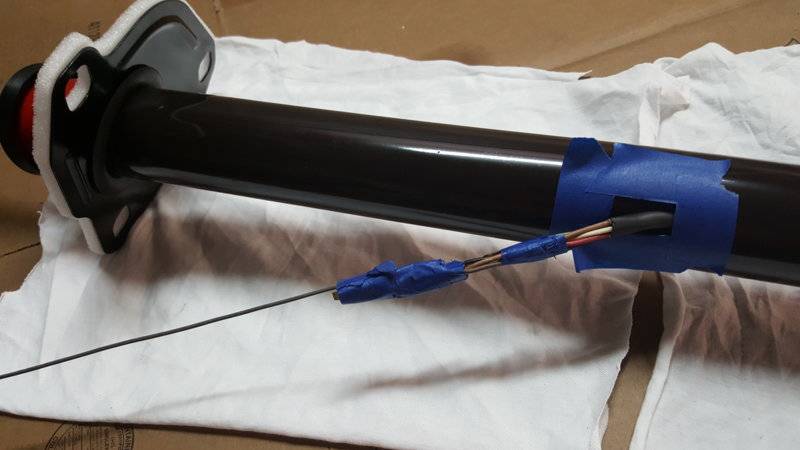

A little trick to getting the wires back in, just run a stiff wire through the tube, then tape all the wires to it and pull them through.

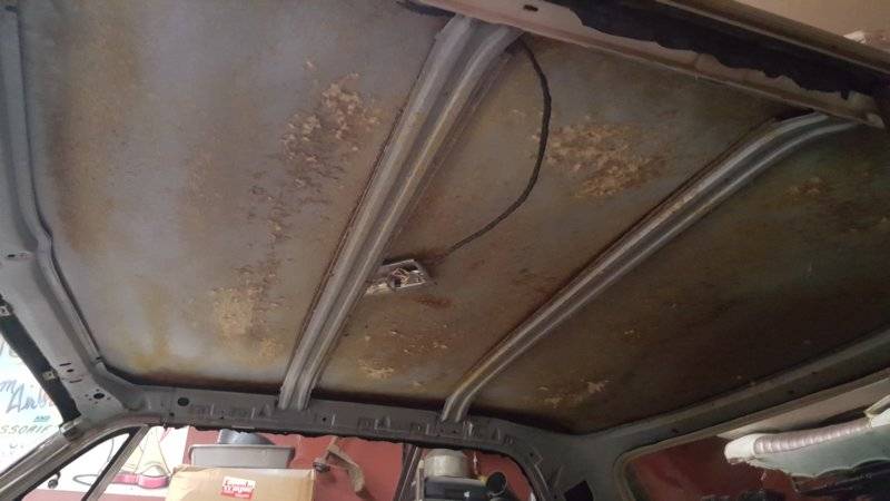

Then the next board is where the interrior light goes. Transferred the plate to the new board.

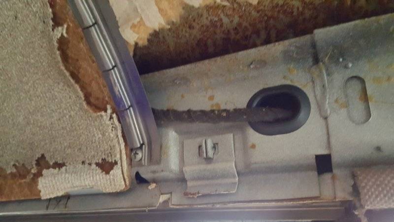

I fed the wire and bulb socket through the hole before installing the board. Same procedure, bowing it down in the middle, then push it up.

The wire for the dome light travels? I assume up the drivers side piller
Wow thanks, would have never guessed
