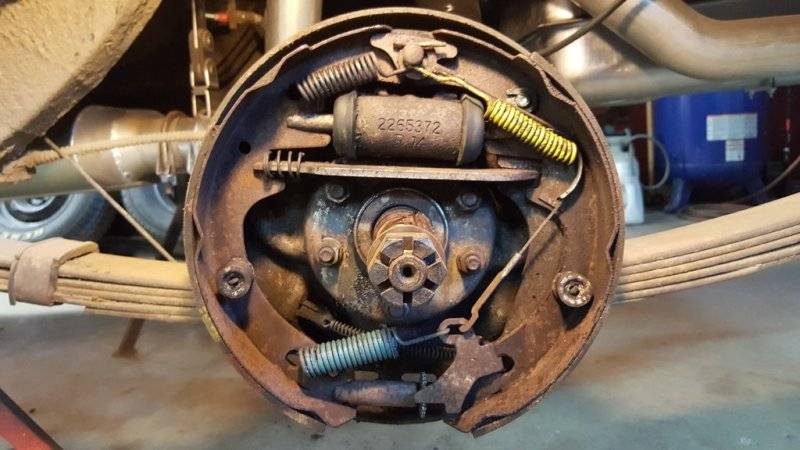

So, I have the back half of the '64 all tore apart for some detailing underneath and a long overdue suspension rebuild..... thanks to Icetech and the others who responded to the recent thread about +1 springs on an early B, I've got some Espo springs coming for that part.....
So, I pulled the rear and I'm thinking it should get some upgrades; brakes, gearing and traction control since this car is headed for pro street(ish) big block swap.... think Maxie clone....staying on the street. I threw out the idea of superstock springs, and now I'm wondering the best approach to the axle..... really wondering if just a total replacement is the way to go???? I know an S-60 would be nice but that's not going to work for a vintage 64 Maxie clone, right??
And lastly, is there availability of a complete 8-3/4 setup available?, or should I be looking to piece together this old one? Also, kinda wondering if anybody would need the leftovers here, whichever way I go??

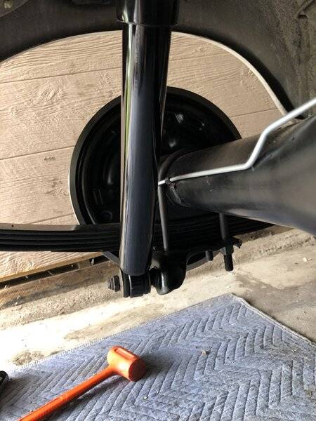

I did the replacement on my '62. Dr Diff has the axles ect. They are stronger than the original axles. I found my own brake parts. I believe Cass offers complete setups also. The '64 of course is wider than the '62 but you get the idea in my thread.
Post in thread 'Taking Up New Residence' Taking Up New Residence

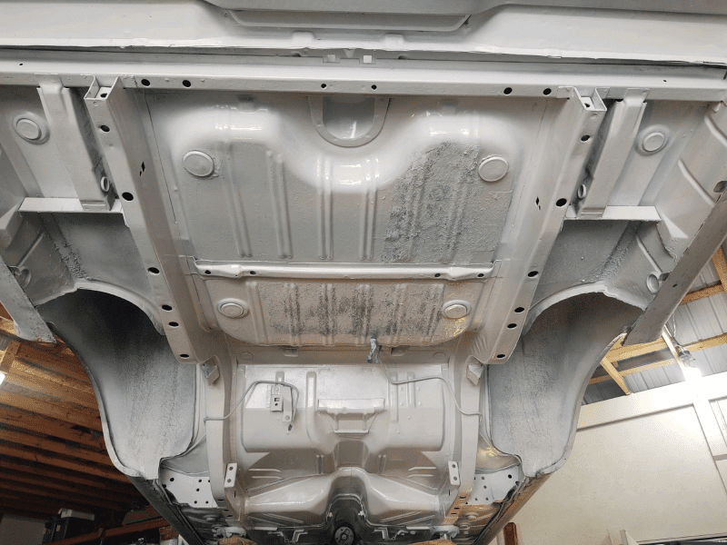

Tried to get busy on this just the past couple weeks....definitely tough when work and life demands come first..
Here you can see the spring clearance if I stick with the `64 housing.... gotta research some costs....but it's looking like that's what I'm gonna do.
Steamclean....disassemble....
etch...treat....prep and paint. Now I have a clean palette to work from. :thumbsup:
