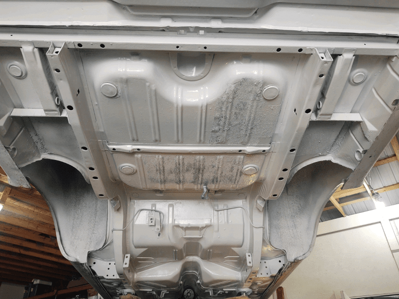

I know you guys are scattered everywhere and see some cream puffs now and then.....but us schmucks in the rust belt really can appreciate finding something this clean!!

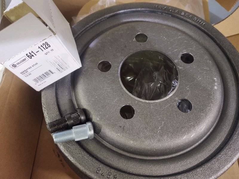

Little follow up...there was mention of this webpage and his drum conversion, retaining the tapered axles and hubs, yet changing over to the '65 and up type drums..
Mopar Tapered Axle Brakes

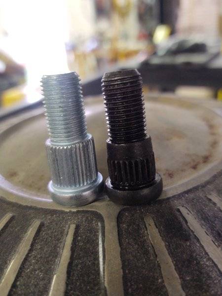

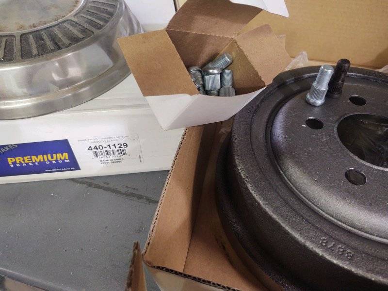

I ordered the parts thru NAPA, same as he did, to see if this can still be accomplished (as it is an older conversion in the webpage). Sure enough, drums look like they are easily available....wheel studs it appears that they had to scrounge multiple warehouses throughout the rust belt to come up with the eleven I had asked for. But the stuff is available..... more parts and details to follow.
