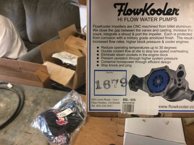

I’m going to try flow cooler this time for the pump. I had great luck with edelbrock before on different cars. I haven’t had one since private equity got involved and I always see PE as a red flag. Especially for healthcare. I’m finding my factory 440 with AC car is running a bit hot with the ac on.

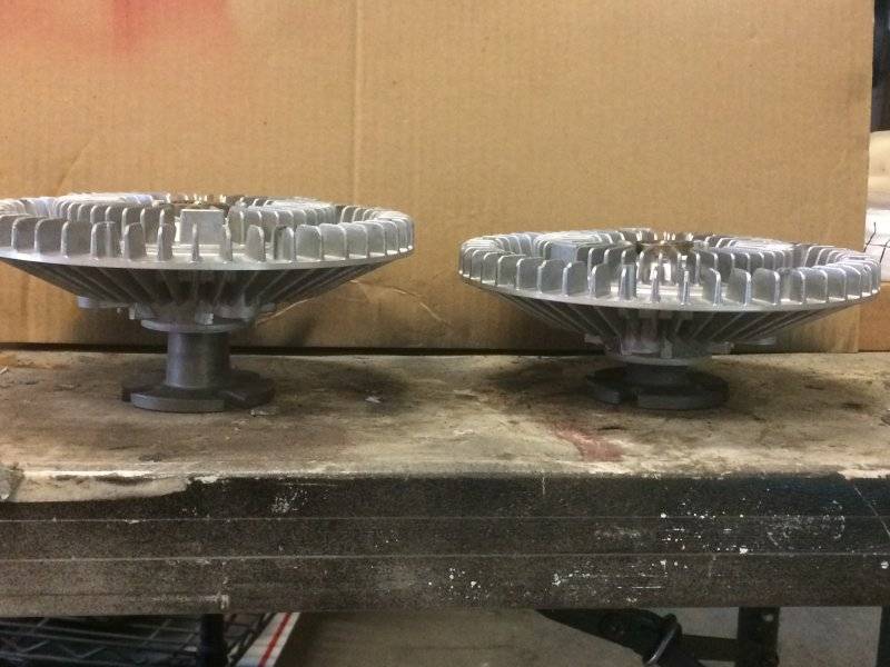

I did have another question. I purchased a replacement fan clutch (Oreilly's part #2747) because that matched the fan I had in there previously (it was recommended to replace since I replaced my fan). Is there a different fan clutch I was supposed to upgrade to since I put the AC kit in it?
If you have the room to accommodate it, the 2747 is fine. It is the one to the LEFT here:
It is fairly easy to install. The one to the right is the stubby 2947 that we often have to use with thicker radiators. That one is a pisser to install. If the taller 2747 fits, I highly recommend that you use it.
Ok good because that's the one I installed....
