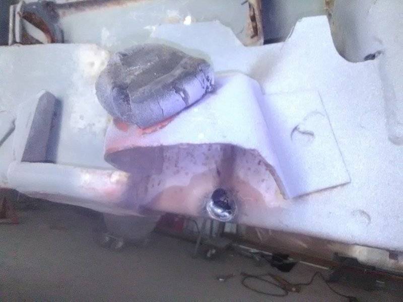

you know the one..... it laughed at my impact gun, and bowed my breaker bar.
I have gotten through the decades without an acetylene torch, but every now and then I wish I had one; But being a master of improvisation through necessity, I prevailed in a matter of minutes.
risking the seemingly inevitable can-o-worms, I drilled a small hole (5/16 ish) in the side of the rail next to the welded nut; then proceeded to point the mig welder through the hole. I hit the nut for a few seconds, hoping not to penetrate the threads (can o worms mentioned earlier). Got it good and red, pulled on the breaker bar (with a pipe) and BAM! it moved!

for the "pics or it didn't happen" crowd ……. I will weld the hole up next time out there. I will first thread the bolt back into the hole to prevent a piece of weld spatter from ruining my day...…. cause it will, if I don't :rolleyes:

So....Am I to understand that you were trying to remove the K member and the last of the 4 bolts was difficult? You drilled the hole to add a small amount of welded reinforcement to the "cage" around the threaded nut ....and the heat from welding helped loosen the bolt enough to remove it?
there is no cage, the nut does not move...…… it is welded solid to the rail...…. I hit it directly with the welder, back and forth as to not burn through, 4 or 5 seconds is an eternity and heated it like a torch
In the A body cars that I have cut up, there is a stamped steel "bracket" that lays over the top of that threaded nut. It is welded to the frame rail, not the nut. I would think that they did some if not all B body cars the same way. I don't recall the year or model of your car though.
