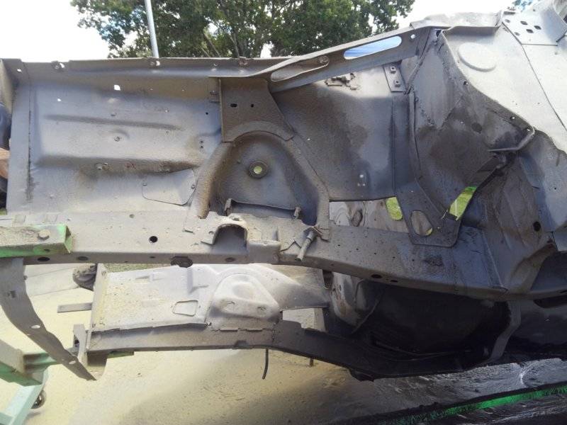

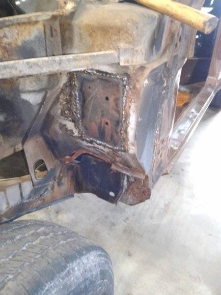

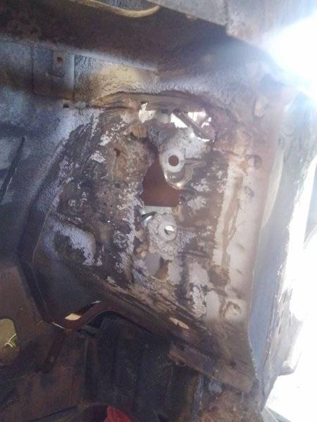

Cut the rusted parking brake area out made a plate welded it back in !

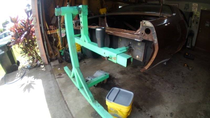

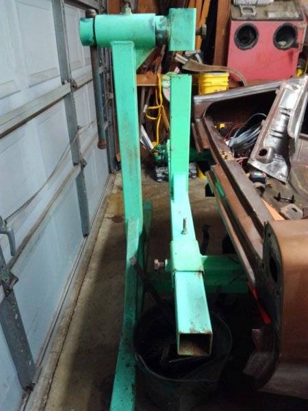

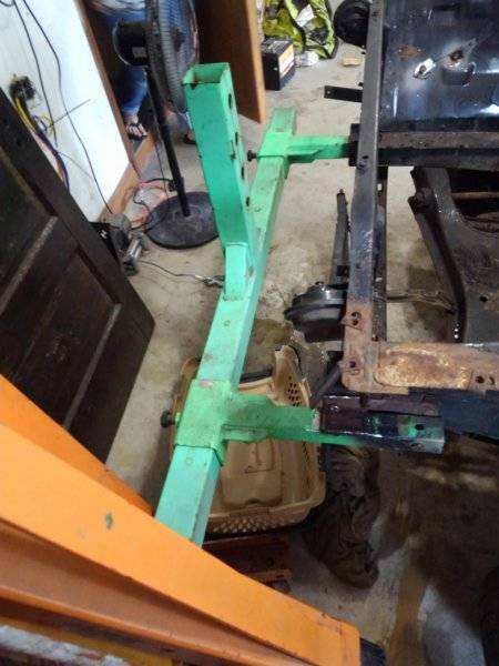

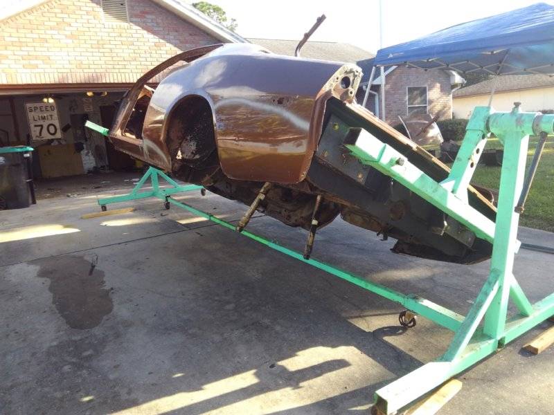

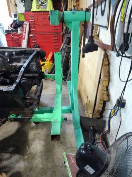

Set up the rotisserie found out it was not all ready set up for a b body!
Had to modify a bit and added some brackets ! I need to figure out how to mount the rear bars

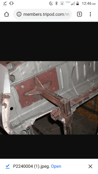

Any one got a picture of how to hang this beast off the rear? Do I use the bumper holes? Seems kinda weak ? But what's a empty shell 1000# ?
So I found this on Google.
Not sure if I'm 100% sold that's alot of #'s hanging off that panal ! I see it's reinforced on the back what do you guys think ?
Not sure what ur asking.
But if your talking about the plate: if its gusseted and 1/4 plate, that should work. 3/8 plate would no doubt be stronger. I'd go to the wall thickness of the tubing and just match the thickness there.
Sorry meant the panal on the car itself where they have this rotisserie bolted to!

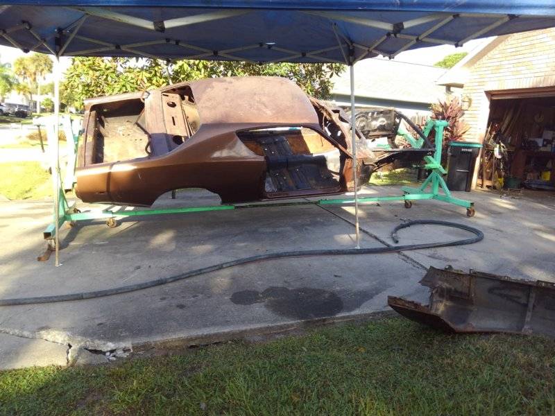

So made a bit of room in my garage today ! Made the brackets up for the rear section for the rotisserie! (Ran out of gas) so tomorrow I'm getting my tank filled and finishing my gussets! Then I'm pulling the rear and k frame out and sending the charger in the air!

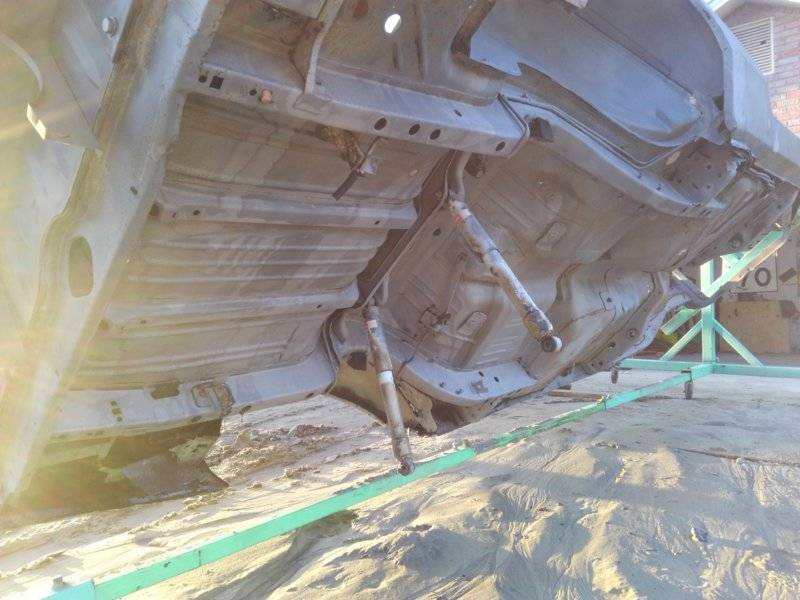

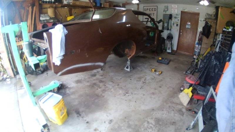

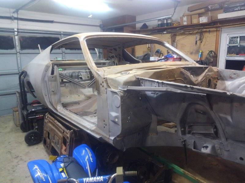

So the charger is officially in the air all 4 corners!

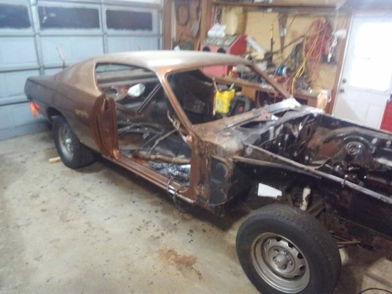

Pulled the leafs and rear out started getting k frame out but my garage time got cut short yet again .

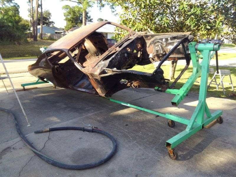

I was çoncerned about how it would spin figured it would be hard ! Well fairly easy I must say ! The fun will get to start soon

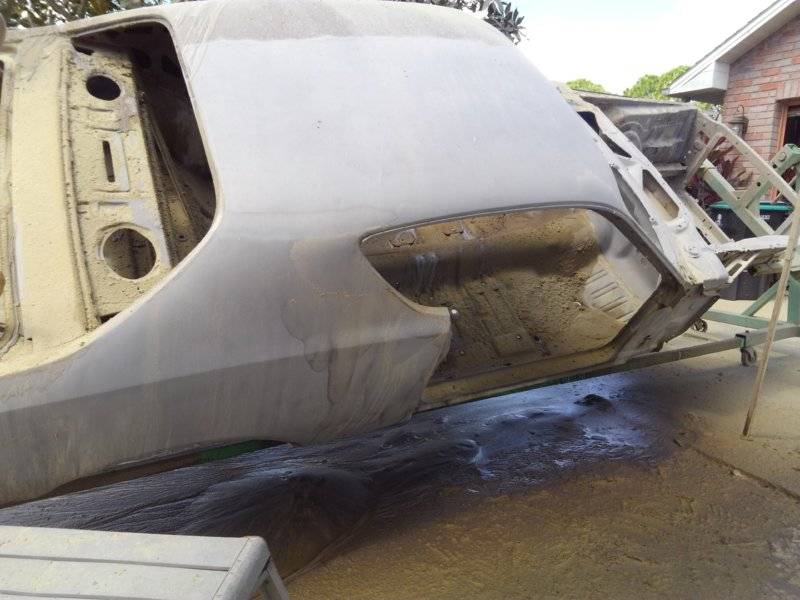

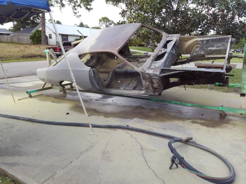

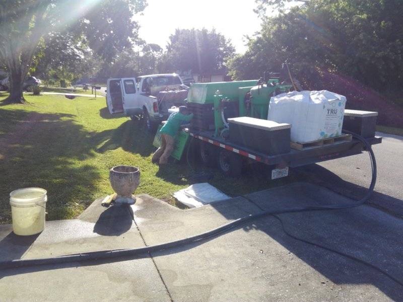

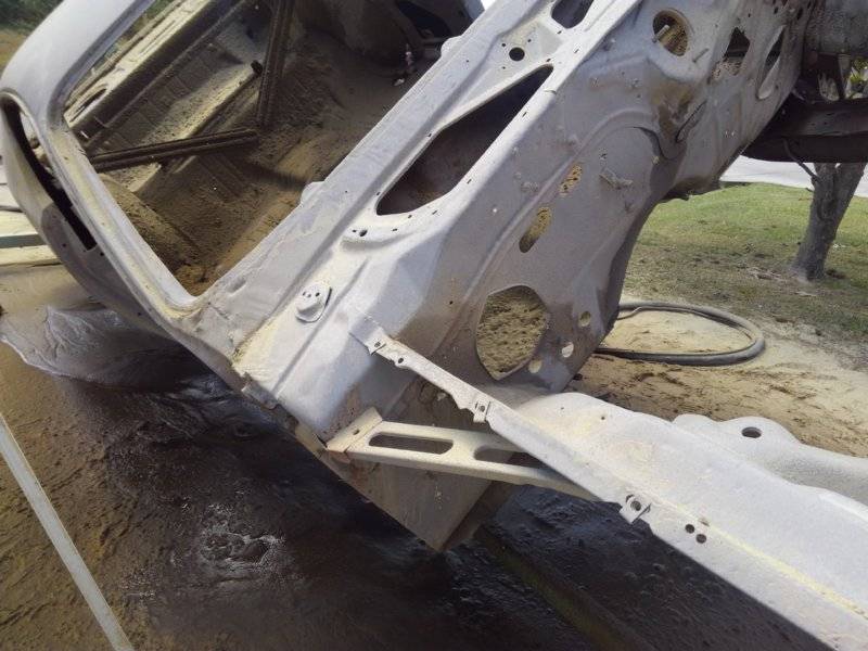

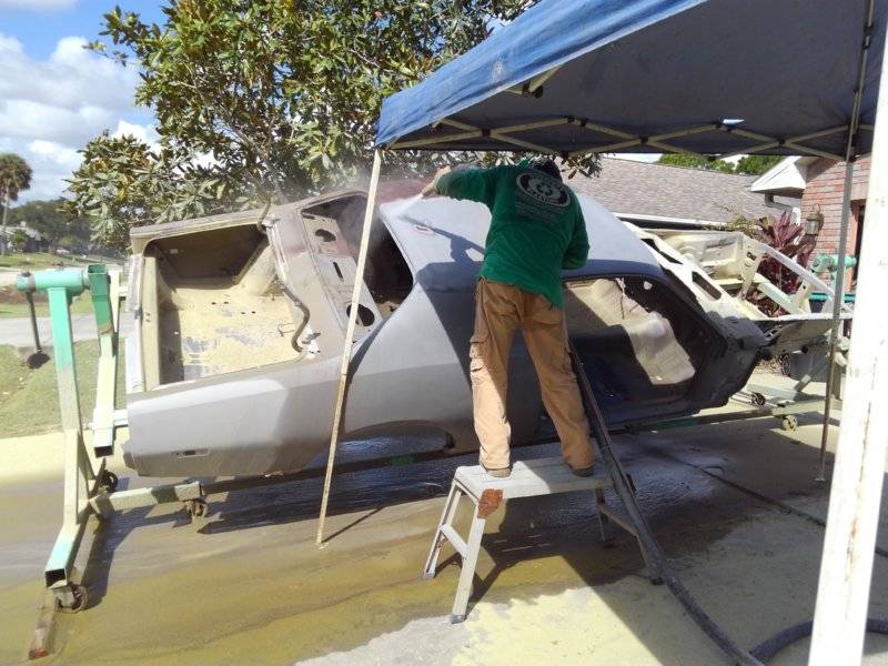

Well for those that have been waiting the dustless blaster was finally hired and he showed up today!!!!
So we ran out of time today,he has to. Come back tomorrow night or Saturday to finish up the doors ,hood and fenders !
I'm a little scared of what the doors might be hiding. We will find out soon !
Trust me - been there, done that.
Years from now you'll still find sand coming out of the nooks and crannies.......
But it's well worth it - it looks great!

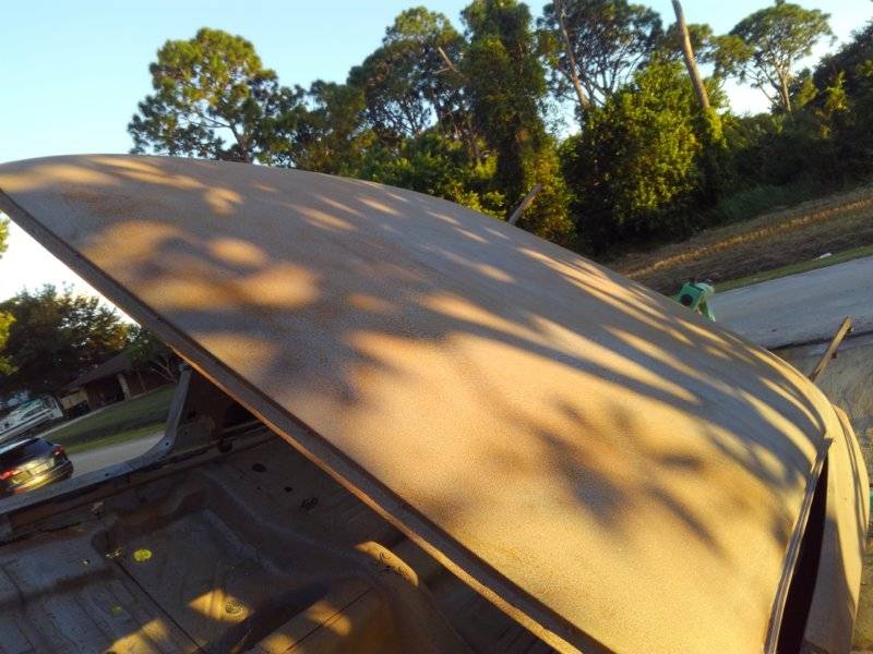

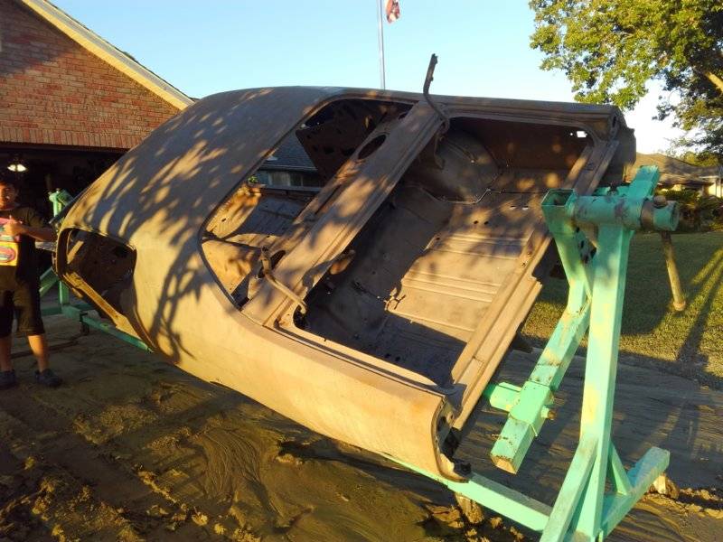

So much sand!

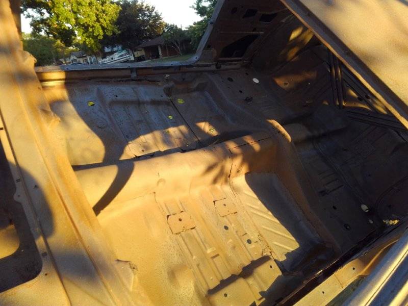

My driveway looks like a beach I got alot out of car going to roll it back out today or tomorrow blow it out really good and prime it
