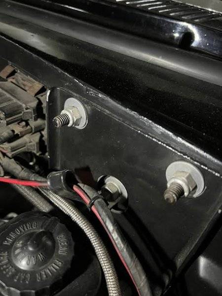

The Elephant In The Room: unloading the load from a B-body.
Aluminum/plastic dual master cylinder is 2 Lbs compared to an iron one that weighs 6-1/2 Lbs.
Firewall mounting plate weighs 1/2 Lb compared to a steel type that weighs 1-1/2 Lbs.
Top lock nuts and washers are 0.45 of an oz compared to the stock 0.60.
The pair of bottom bolts and lock nuts are 1.00 compared to 1.40
It is beginning to look like there is not a single nut/bolt/washer made from steel left on your amazing car.

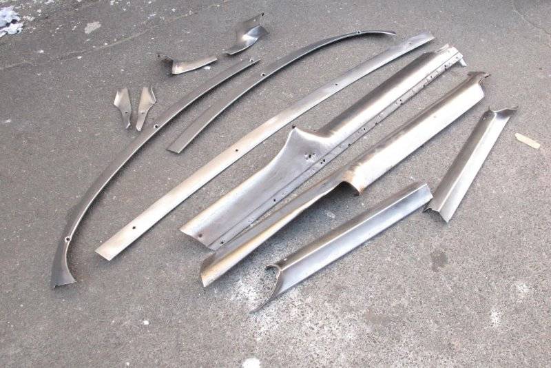

Here are the interior trim pieces that hold the headliner material in place as well as cover the raw A-pillar posts and close off the dashboard frame ends. The two B-pillar trim covers which were also metal were easily made of light gauge aluminum, so they are not shown here.
What y'all see here looking like cleaned and prepped for paint trimmings, are actually drying out after a few baths in baking soda followed by denatured alcohol. and then prep sol degreaser.
Why?
They are relieved of a few pounds of their own skins after a dunking in the acid Jacuzzi.
Yeaaap, that sh!t still happens. You see, a number of years ago on one of my trips to Detroit, I was introduced by the ever so generous Dave Dudek of F.A.S.T fame to a gentleman that I appropriately named "Kulasa The Dipper" This Dipper guy was in the business of etching and texture forming interior plastic and metal panels, so in between he could moonlight as a Jack LaLanne alchemist for weight conscious crazies.
Based on that professional experience and depending on the density of the part, he would scientifically figure out the amount of time and solution strength needed to rid the clean metal parts of a few ounces and in most cases, even pounds. Timing was everything because without it, things could literally disappear like a Wiley Coyote experiment gone bad. Needless to say, he got the nod to dunk these pieces.
They all went in the vat weighing a factory 6-1/2 Lbs, but when they emerged, 3-3/4 Lbs was their new scale numbers. Right there 2-3/4 Lbs had fallen off.

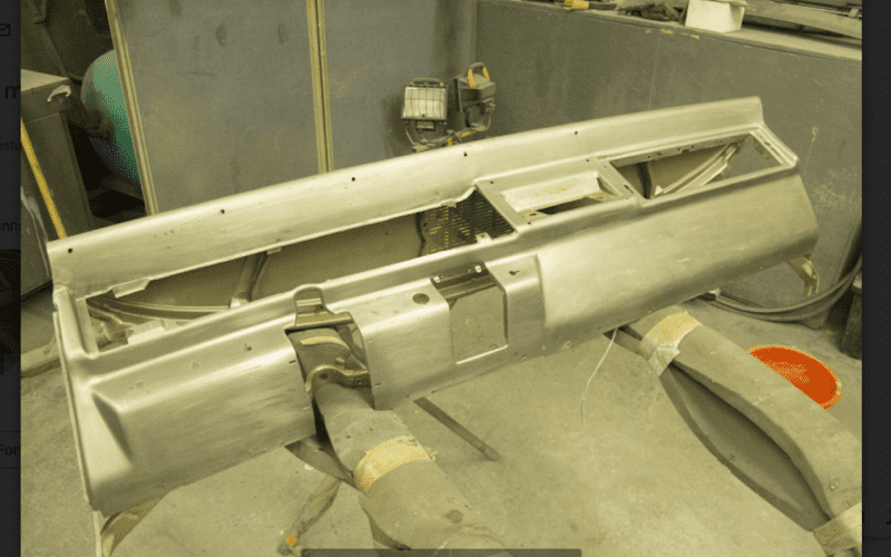

Being that we're on the subjects that are in the vicinity or part of the dash frame itself, here's a little something on dashes.
For some time now, I have been in awe of what is probably one of the holy grail parts to emerge from camp Chrysler in the 60's; the coveted but elusive aluminum dash frames that were allegedly installed on the 1964 2% and some 1965 2% AFX cars.
Like a needle in a needle stack, these things are hard to distinguish from your production line pieces other than that most were made out of steel and the others of the light alloy. I happened to see one at the Nationals for sale years ago as part of a broader package and because I could not afford it, I miss fired and it slipped away into obscurity. Since then I've made peace that I will never find or see another one of those pieces which brought me to this, lighten what you've got.
Obviously, I've never had the opportunity to lay an aluminum one on a scale, but I would bet that since a steel unit weighs in at 17 Lbs bare skin, that an aluminum one should weigh in the neighborhood of 7 - 8 Lbs.
Making one out of aluminum is like trying to have a regular horse give birth to a Unicorn, almost impossible without all the right tools, measurements and long winded patience, so the next best thing was to investigate chemical milling.
Immediately, a realistic conversation with Kulasa The Dipper went into affect about how much could be extracted from a steel dash without compromising its integrity and how much would it weigh?
Thereafter, a perfectly preserved and stock dash was found at the swaps for about 50.00 bucks and away it went with a prayer to the summer jacuzzi day camp. Kulasa assured me that it would be a successful dip.
When the day came to go fetch it, I was floored. He preserved all the structural and mounting points and handed it to me with one hand balancing. He had removed a fair amount of material in the larger plains.
From its original 17 Lbs, it was now 10 Lbs. It had lost 7 Lbs and we were being conservative.
Here it is after several neutralizing baths, washes and anxiously waiting for its first coat of epoxy primer sealer. Keep in mind there were other additions that actually lightened it even more. Stay tuned.
