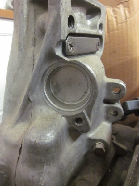

The Elephant In The Room: unloading the load from a B-body.
It is a Dorman 555-059 plug shown as 1 3/4" camshaft plug.
What I love about all of this is that normal items such as plugs at a Home depot or auto store can contribute to a diet plan on a race car.

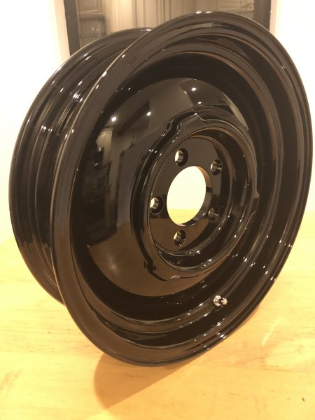

Here's another close look at one of the powder coated aluminum "Steely Dan" wheels.

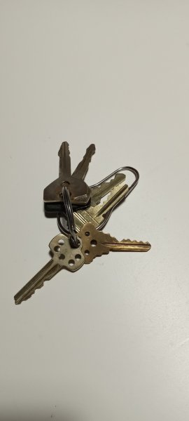

Oh, and talking about lightweight anodized items, here's some good humor ice cream. How about a pair of anodized aluminum ignition keys? Every ounce counts. LOL.
When I was working I had keys to just about everything in the shop and then some hanging from my belt and they were kinda on the heavy side. The company keys were brass, larger and heavier than ignition keys so they all got drilled. Probably took off over a 1/3rd of the weight.

Couple of pics of some of the things I've done.....and of course, a couple of 'lightened' keys I still have. Having holes in the house key helps in the dark.

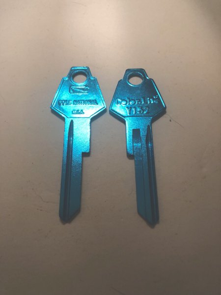

Here you go. Aluminum anodized Chrysler blanks.
Could match with blue aluminum anodized Direct Connection valve covers. LOL.
I race with only one key in the ignition, no underwear, a haircut, fasting from food for a few days and yes, a good sit down in the John and you're as light as a feather. LOL.

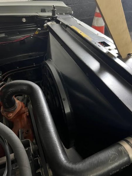

Aluminum AFCO radiator with tailor made aluminum shroud which also holds the high CFM fan assembly. Never logged in how much weight it shaved off compared to the original copper brass radiator, but it was a modest to decent amount only because it is wider and thicker. Widened and removed some of the radiator support walls to allow more air to the wider aluminum core and its tanks. Sealed all openings, crevasses and pin holes.
190 degrees tops in street driven 95 degree oven air.
180 degrees in Fall air.
170 degrees in dead Winter.
All fastening hardware are aluminum.

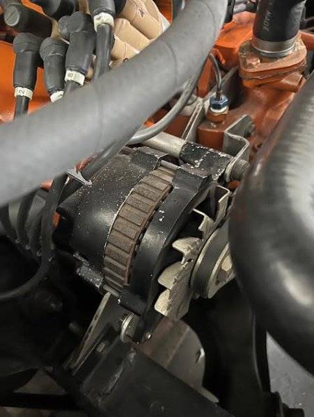

I went over to the Dark side to get a little lighter with the use of a Powermaster Black series GM 140 amp Alternator. My original 35 amp Chrysler unit wasn't juicing enough for the few things reliant on a good alternator so I went there, especially when I weighed the two and the GM unit was exactly 2 Lbs less. I know that now there are even lighter mini Powermaster juicers that look more the part in a Chrysler engine nest, but don't have the time to prefabricate those brackets at this time.
Speaking of brackets, Note the aluminum brackets and aluminum hollow spacers where the Titanium mounting bolt slips through to mount the juicer to the engine. Been working for years trouble free.

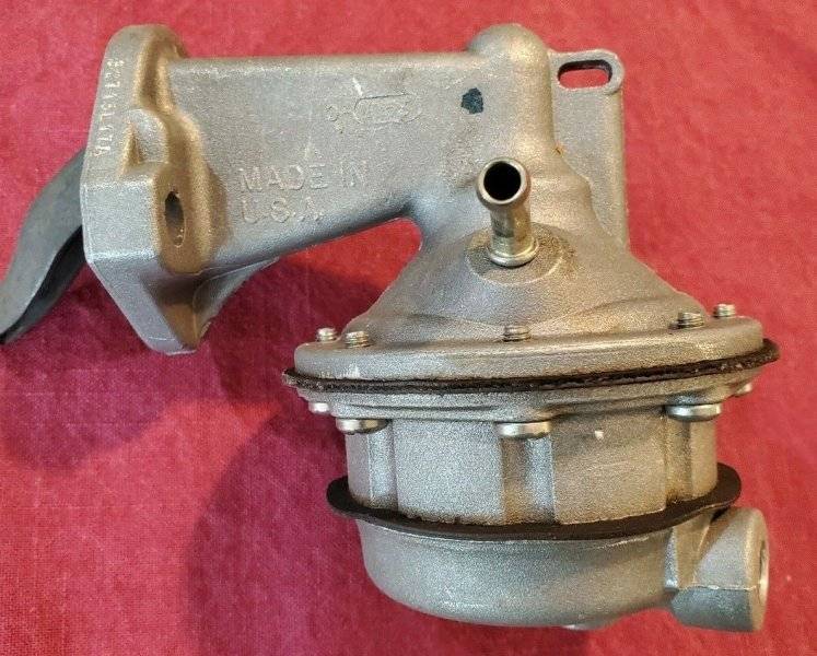

While region #1 is coming to a conclusion unless there's an elusion to other tricks, a big block fuel pump can weigh as much as 3-1/2 Lbs with push rod and all at the very front of the car. All this can be switched to the rear of the car with the use of an external electric fuel pump or in-tank unit. Not necessarily removing the weight, but repositioning it for more effective weight distribution.
My fuel pump weighed 3 Lbs with push rod. Electric in tank unit weighs a little more, but placed in the right place.
