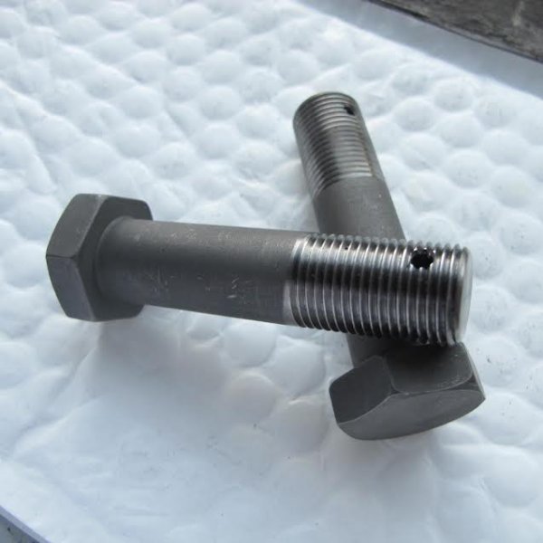

Backing plate bolts. (8) pieces. Shaved almost a pound between the both sides. Could not find the castle nuts in Titanium, so I had to go with stockers. The cotter/stop pins are Ti though.

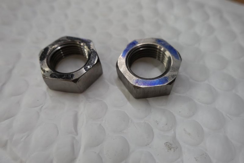

Titanium spindle nuts. Just checked the records and the factory version was 0.85 of an ounce and the Titanium piece was 0.55

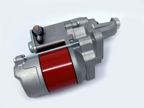

OK, I received the mini starter I ordered from 440 Source, the one advertised as 7 pounds. Right out of the box, it measures 7 pounds 17.5 ounces – well, 8 pounds 1.5 ounces. In all fairness, I sent them an email asking for clarification on this. I will likely be told it is a typo in their ad, but there you have it. If you want a 7 pound starter-this ain’t it. I will let you guys know if I get a response.
Bait and switcharoo.

Does this 7 Lbs starter going on 8 Lbs have heat shields attached? It doesn't look like it from what the photo shows.
I made up with Titanium mounting bolts and nuts on mine. Sorry. don't have pictures.
Perhaps Titanium nuts on the electrode posts and bolts on the housing will bring it down a little. LOL.

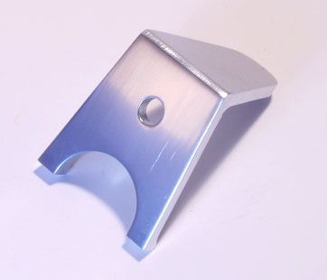

While the subject is still hovering around region #1, here's a hold down in aluminum by the same company that is distributing the supposed 7 pound starters. I made mine way back in the 90's and it's a feather still holding the hold. Titanium bolt.
Badvert65,
Thanks for the weight info on your new starter!
I hope the purchase was not based on the weight being 7lbs!
It is 2.5oz lighter than my current starter and spare!

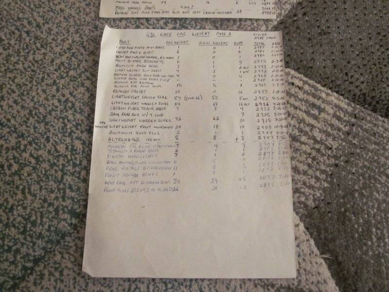

So back to my GTX weight loss story!
As I mentioned the GTX was over 3600lbs new in street trim.
I knew all along making the car lighter would make it faster!
But back in 1998 when I started racing at "ROUTE 66 RACEWAY" in Joliet, Illinois things ramped up.
They had a very good scale at this new track.
The first time I weighed the GTX there it weighed 3385lbs!
So that is when I started my weight loss log and making notes.
I would jot down the item with the old weight and new weight.
Then I would show the difference and new accumulated total.

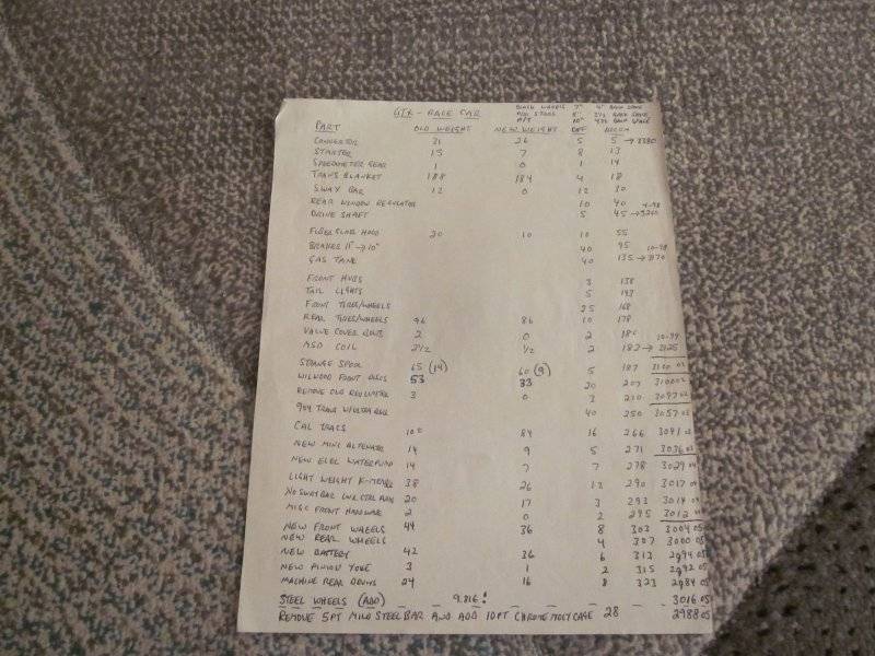

So my attached pictures show those log sheets.
The first item is that I went with a higher stall convertor and it dropped 5 lbs of rotating weight.
The old convertor weighed 31lbs and the new convertor weighed only 26lbs!
Lee has been talking about zones on his plan but I think rotating weight trumps any zone?
MJ

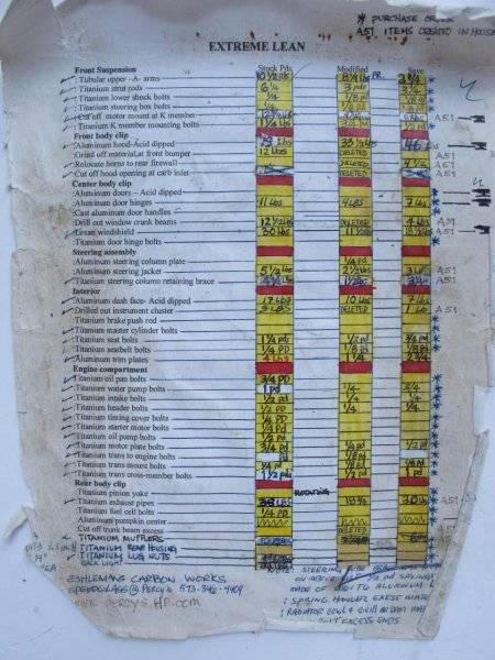

Yes, rotating weight rules over all.
I still suspect that the three regions static weight when removed or repositioned, will boost the lighter rotating weights potential.
From over 3600 Lbs to 3385 Lbs was a feat all in itself for that kind of car. Some people would be happy stopping right there and then. The fact that it is now at 2895 is a moving marvel.
I love the list. We think alike from across many towns.
Below is just one page of about 30 that make up the cars lightweight manifesto. Some items have been further worked over the years to shave more lard. Some pages are maddening in showing 1 ounce shaved here, half an ounce removal there. Grams deleted elsewhere. LOL.
Some items were/are wishful thoughts that could never materialize, but somehow some came through and true.
Lots of drawings created as part of the portfolio, but I will only release a few as the region comes into play.

So recently we have been discussing starters and that is the second entry on my list.
I went from the big traditional starter to a mini starter and shaved 8lbs on that item.
I would keep a running total of the weight loss.
Occasionally I would scale the GTX and verify my numbers.
MJ

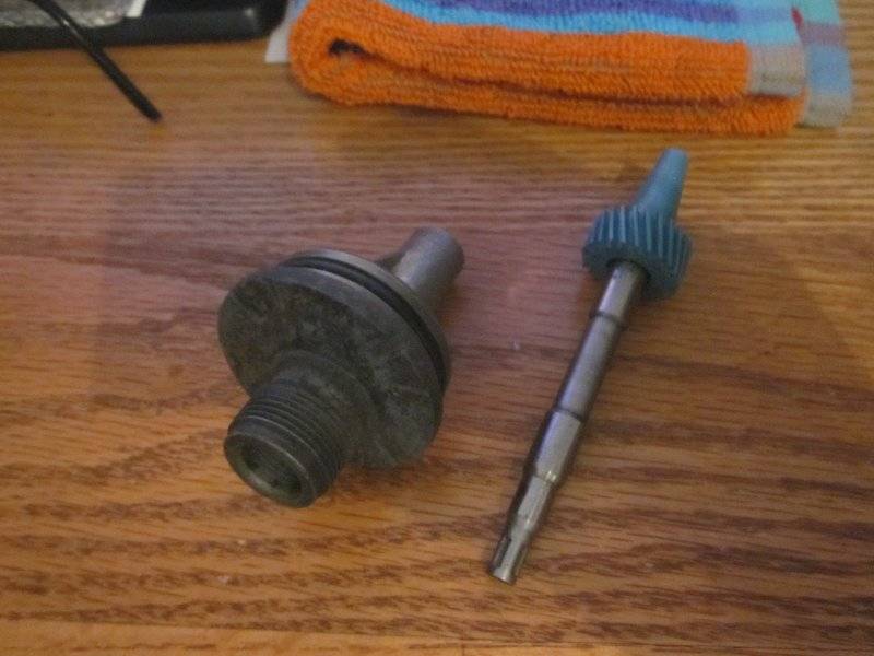

So the next thing on my list is the speedometer gear at 1lb reduction.
This is for the gear, gear housing, clamp and hold down bolt.
You don't need a spedometer when it's a dedicated drag car!
I simply found a lightweight plug and blocked off the opening!

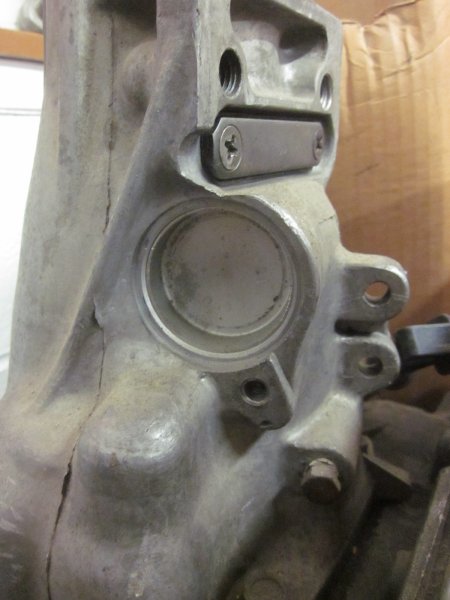

This is almost like the A-864 Hemi transmissions with the parking gear removed. The transmission tail housing (rare) had no provisions for the parking gear mechanism.

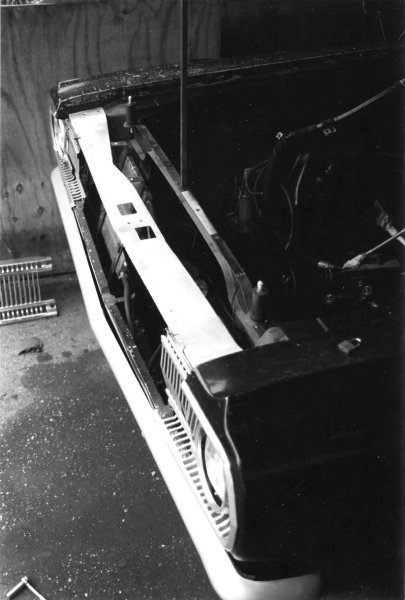

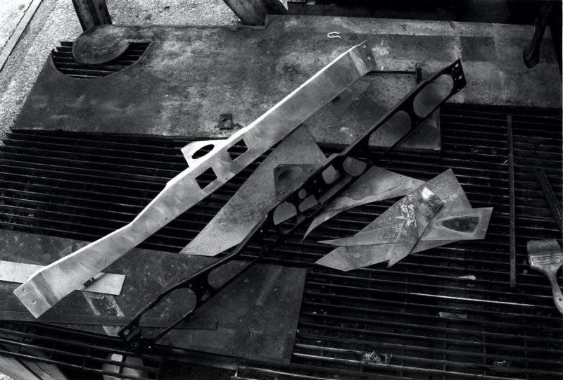

Before going any further, keep in mind that the emphasis with these two parts here was to mimic or surpass what the factory had done with the 1964 A-864 Hemi cars and the (4) 2% cars of that same year. When these parts weren't available either out of rarity or exclusiveness, upping the ante was in full view.
I found some old images of the original steel top grill cross brace that was hogged out years ago. In stock form, it weighed in at 3-3/4 Lbs. Hogged out with the oval holes it only lost 3/4 of a pound. It was all good with me at the time but when the decision to go aluminum came along a short while later, it was dropped down to 1-1/2 Lbs. This was all hammered and break formed just outside an old Submarine hull building facility at the original Area 51, The Brooklyn Navy Yard.
I found some images of the original steel top grill cross brace that was hogged out years ago. In stock form, it weighed in at 3-3/4 Lbs. Hogged out with the oval holes it only lost 3/4 of a pound. It was all good with me at the time but when the decision to go aluminum came along a short while later, it was dropped down to 1-1/2 Lbs.
The top grill cross brace installed in place. The vertical latch support braces were also of the light alloy. Being that four hood pins were to come in service, the lock latch got shelved.

So here is a picture of the transmission tailshaft with the plug installed.
I also forgot to mention that the removal of the spedometer gear reduced some rotating weight!
Just a little bit less to get turning when I drop the hammer on the starting line!
