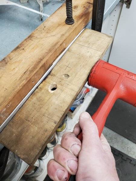

Not everyone realizes you don't need high dollar tools to fabricate. Just need to think outside the box. Though not all of us have FMJ's artistic tallent. It really helps when you have a good friend that is a fantastic tig welder. I'm very thankful in that regard.

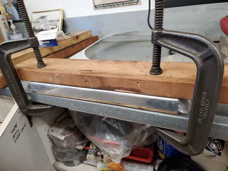

So you see, this is what I love about this community of mad scientists, make it happen with anything and any which way. I've done so much with found objects from the street, including the rare straight and true 2X4's that can be a great help in clamping stuff down for the bends that would rival a break machine.
Yes, having a class A-welding ace within a phone calls reach is the ace card to making anything.
Doug, the next time I'm in the D, can I borrow some of those 2X4's out of your tool box. I promise to bring them back. LOL.

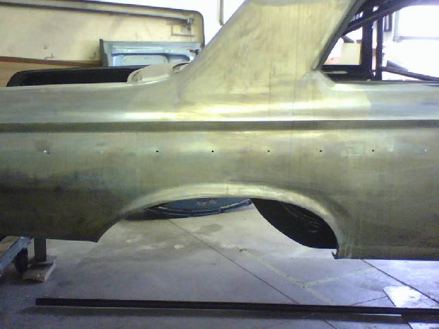

Only if I can borrow the jack handle. The lower 1/4s on my race car were bent around 10" PVC. This car had missing corners of the wheel well. And all the way to the door. The front lip was moved 4" forward, axle 3". The lower rear corners were hand formed from 3 pieces welded together. First time. Never made large patches before this.
