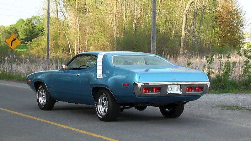

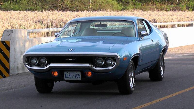

Well i finely took my 360 into the machine shop for a rebuild.The ORG 318 did just fine for me thus far cant afford the 340,or 383, but i have had 360 in the past i like them.MONEY is a big problem, never could spend much on rebuilds,so once again i am stuck with a stock build,with the comp cam 262 hyd.This is the final thing i planed for my 71 i love this car and plan on keeping this 1.Thanks for reading.

Looks good! Always like the ‘71’s. Good luck with the build!
Nice ride. Hope the new build works out well.
Good looking car, I like the stance! 440'

Nice.
What color is that?

I was gonna say KB5, which is a 74 and up color and has a little green in it making it turquoise-y.
Looks GREAT with a black and white interior.
