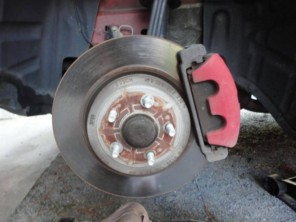

Here is the factory original front. (except I painted the calipers years ago)
I did not measure pad grooves, straight edge or mic the rotor, etc., but I figure 60K is a fair amount of use from them.

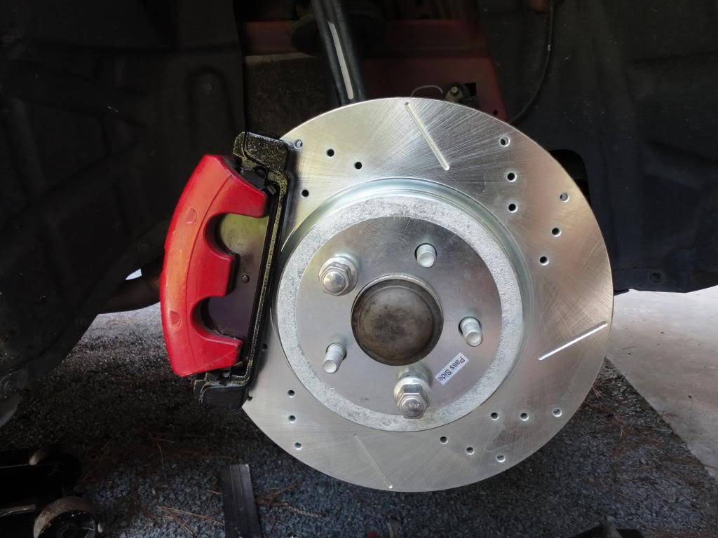

The new rotor and pads. (I also threw a coat of gloss black on the caliper brackets while I was at it)

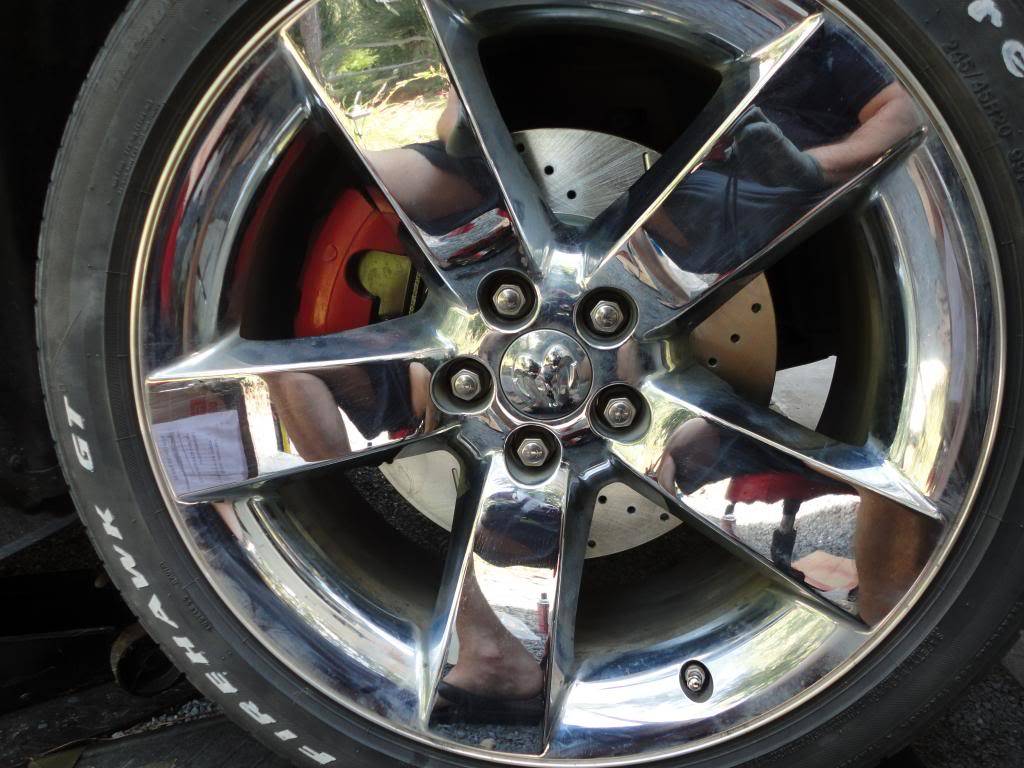

Wheel back on.

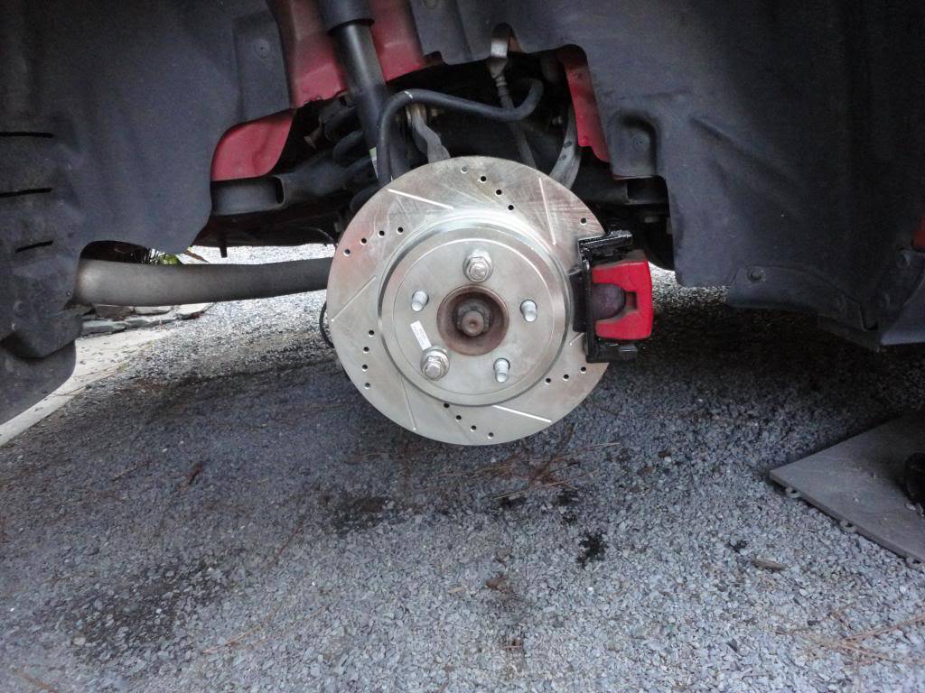

New Rear
