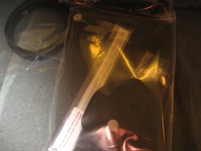

Got this delivered today from The Mopar Fairy

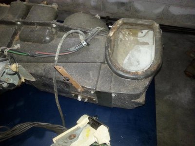

I'm getting ready to get this kit for my 71 satellite and was wondering if you could answer a question for me, the heater box to cowl seal I'm seeing in the kits are different from the way mine is made ,it looks like you have a round one where mine is flat on the sides and end then the other end is round, do the round ones form into this shape?Sorry about high jacking your post but I thought this would be a good time to ask for some help.Here's a photo of mine.20140215_152108.jpg
cool deal. I need to have the Mopar Fairy come to my house sometime.

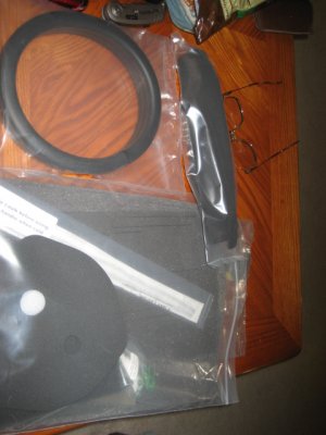

It looks like my new seal is kind of oval. The old seal on mine looks like it was oval at one time but it looks like it was pushed up to fit from the factory. On the backside of the new one there is a groove all the way around it. I just started to clean mine up. The heater core is under the large seal. Be careful when you seperate the two halves. I've got to fix some plastic on mine. One of the edge pieces near a nut plate is broken. One of the screws for the ac condencer was pulled through the plastic.
