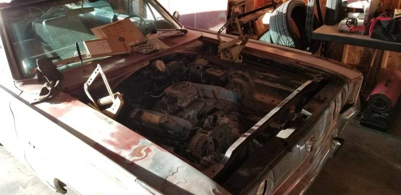

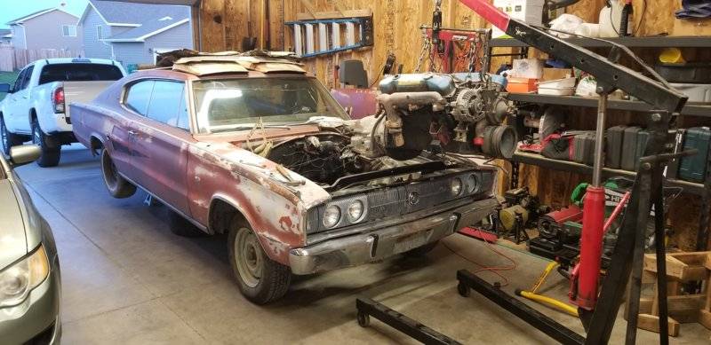

Everything else has gone smooth thus far. The 440 engine out of a motor home has been fun to learn about, what is the same and what is not. Didnt think about the Engine mount brackets being different and stuffed the engine in trying to mount it. No go. Luckily a call to 440 source got me some nicer black plated mounts and shes in the bay now. Also had to temporarily remove the oil pan since it was a rear sump pan. Was planning on replacing it anyway with a bigger pan anyways so that works out.

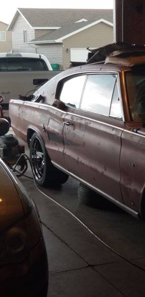

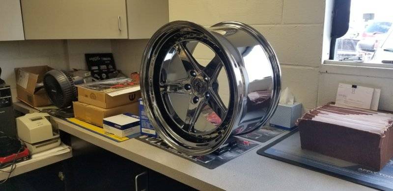

While i was back there i went ahead a replaced the wheels and tires. Going for a more pro tour look with this car, so i found some cheaper 19x11's to test fit to make sure what will fit back there. Put some 305/35zr19's on it, looks decent i think, have a little more work to get the stance i want, rear end needs to come down a few more inches, but that will come with the rear coilovers (probably from magnum force)

Those log exhaust manifolds are HEAVY.
Headers in the future?
oooh yea. Edelbrock intake manifold already sitting on the shelf with my old Carter Comp AFB 750cfm, Some aluminum heads will probably the next purchase for the engine. Currently leaning towards a full TTI exhaust system.

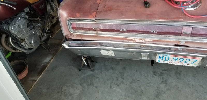

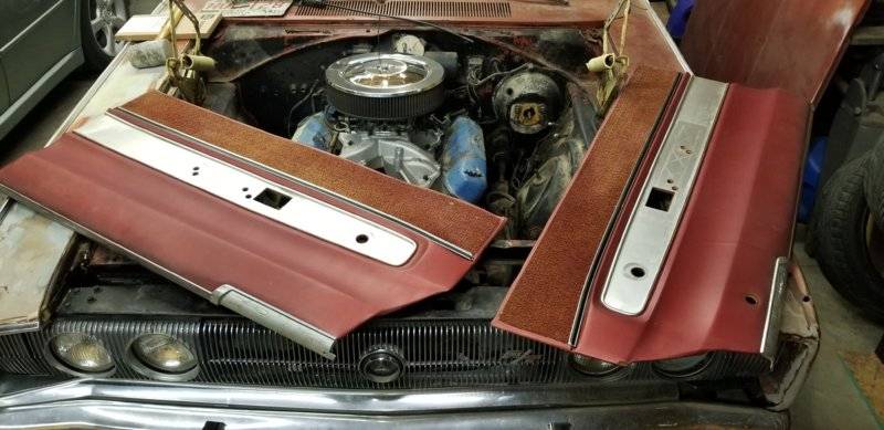

Well, little update, been a while since i've been on here to do any updating. Mostly have been collecting parts so i can get cranking on this thing when it warms up outside (its a blistering 0 degrees here currently) I've hooked up with a local charger guy (super awesome guy with tons of cool stories). He restores just 66-67's specifically and has a small collection of them he uses for parts. We've talked and he has let me go out there a few times and pull what i need and be barter prices. This last time i was out there i picked up a drivers door latch (mine was missing), some full door panels that are in good shape (will take to a vinyl shop to fix and recolor), and a rear bumper. (mine was missing) everything needs some touching up, but being as this stuff is unobtainium it was good to have a good starting point with these pieces.
On the engine side of things i started collecting some go fast parts for the engine, MSD distributor, headman headers (temporary to get it running), milidon exteral pick up road race oil pan, eldelbrock rpm intake, and some little other nick nacks.
