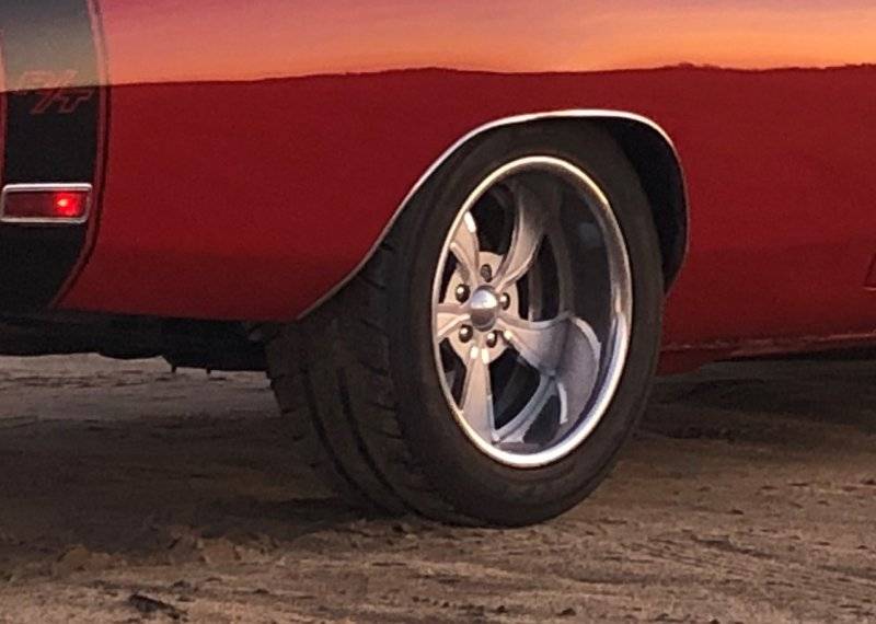

Have a link?Yep… you’d be able to fit a 315 section tire if you desire.

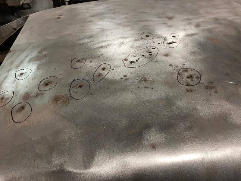

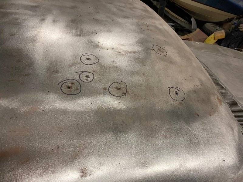

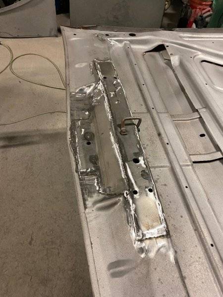

Between these holes and some rotted nastiness on the trailing edge of the roof, I'm told that changing the skin is the better way to go rather than trying to repair all these holes.

That sucks, but at least roof skins are available. I wouldn't have expected that on that car. I have been lucky and never had to replace a roof on any of my cars.What my afro-headed friend is referring to is that a roof skin replacement is needed. I would never decapitate a Charger's beautiful roof line.
