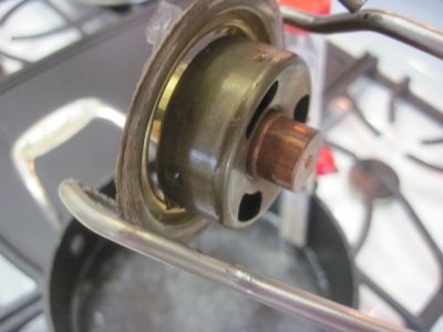

How far open should the thermostat get.
This is how far mine opened after reaching 210 degrees
How long was it in 210 degree water? I like to test a 180 stat at 180 for a least several minutes.
I didn't time it but I would say for a few minutes before turning it up.
I can pull it open about twice as much as in the picture.
Is it a Mopar stat or one from AZ or someplace like that? Someone in another post was saying that the aftermarket stats were not like they once were....
Did you boil it in water? That's what I do to test them and I know I've seen them open more than that. If it opens 25% of the diameter of the hole that should be enough to allow for adequate flow.
