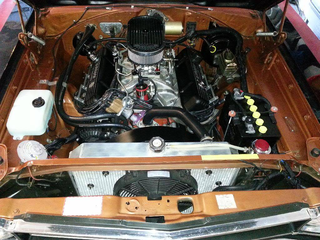

Ok here is something interesting, Background - running PCV on passenger side to carb base, closed MP breather drivers side well not closed but enclosed with holes on the bottom'
A week or so ago I pulled a plug noticed oil soaked, pulled a few more more of the same not some much on some but a lot on a couple.
Went round and round in my pee brain about what is causing this, decided to yank the PCV and switch to all breathers.
Went for a run and pulled same plugs and wow oil all burned off, did smell a bit like oil in the cab at stop lights etc not much.
talked to a few guys about it, most of them said run the PCV to get rid of the smell.
Decided just recently right before this last run to use a PCV breather comb.
In the pick right side is MP breather, left side is combo PCV breather, it twist into the oil cap hole which is kinda cool and has holes in the bottom with filter material inside. want to add both are baffled.
Here's the thing, the first PCV I had had some wet oil inside the tube the valve seemed to work ok, but just seemed to always be wet inside sucking wet oil into the carb base.
When I capped it off it seemed better.
Now that I have put it back with this combo I checked last night and again the tube going to the carb base has oil in it? WTF? I know a little is normal but **** I am loosing a 1/8 to a 1/4 qt of oil every 500 miles or so.
wondering If this motor would just live better with out a PCV?
