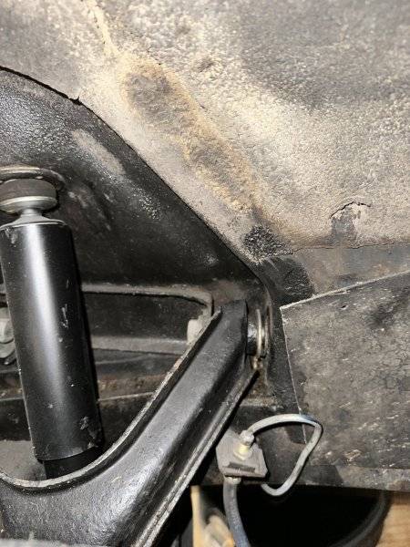

Changing tires on the Bee and seen this on driver side upper control arm.. Thinking bushing is coming out. Was getting ready to drop off for an alignment. Also noticed a bad outer tie rod on pass side. The Bee runs straight no pull but see tire wear on inside driver tire.
Not sure if I'm seeing anything wrong.....
Yep, looks like your arm is rotating on the bushing shell vs the rubber twisting back and forth.
I’d still use it. New bushings with a couple of tack welds and I’d have no worries about it.
^^ If the bushings and sleeves are newer, you could always squeeze it back together and tack weld the existing sleeves in and call it a day. Tack weld shouldn't get hot enough to piss off the rubber.

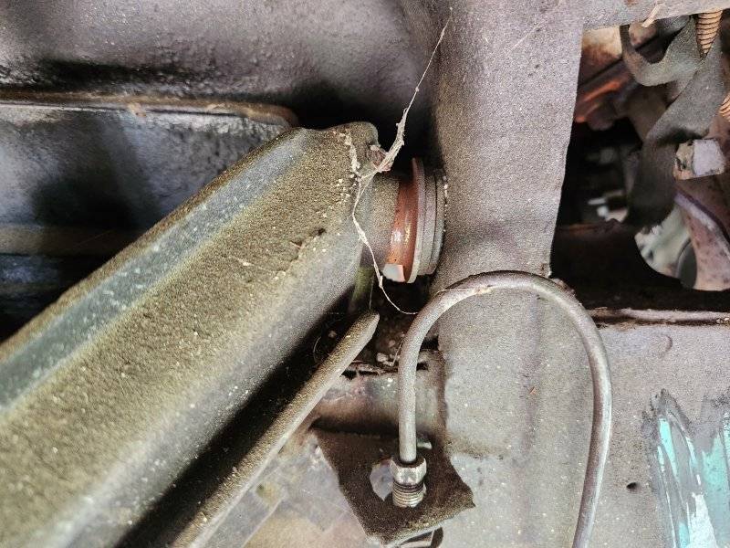

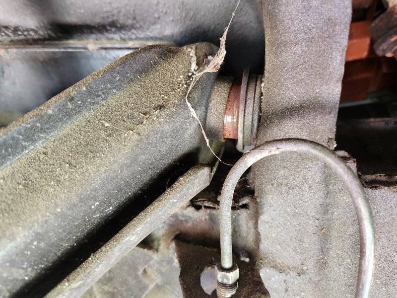

Just me.. I'd be getting another UCA... notice how it's bent on the bushing, more space on bottom than top? That's not normal, something caused/is causing the arm to bend. This how it should look..

just curious what does the other bushing on that same arm look like? how can the arm get that far away from the bushing unless the arm is bent or there is a structural problem with the shock tower.

As hard as those bushings go in, I'm surprised it would do that. I agree with the other guys that say something's bent.

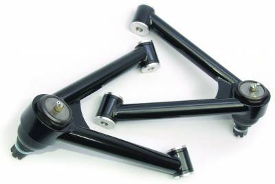

If you're thinking of going down this route, then I'd pay the extra for the PST Tubular Arms ($406 vs $279).
I've got the factory style replacements and just gone through the ball joint/stripped thread issues. The rubber seals they come with are a cheap plasticky type rubber and split after a few years. When I was inspecting them to replace, I notice one of the ball joints was loose in the arm (driver's side). So much for needing a 6 foot breaker bar to get them out - I unscrewed it with a small pipe wrench.
I had 2 spare ball joints from the super front end kit I'd bought when I did the front end, so used these as the replacements. The ball joints themselves seem to be better quality and the rubber seal is better, more pliable and similar to the tie rod end ball joint seals.
Thew new ball joint went into the driver's side well and torqued up ok. The passenger side was tight in the arm coming out...and took half the threads of the uca with it on the way out. On this side I had to tack weld the new ball in. It did go in tight as it cuts its own threads on the way in, but once seated wouldn't torque up. I think the factory design has too shallow an area where the threads are. The tubular arms have a much deeper threaded area from the photos.

How could the arm fit in the tight slots or bushing come out with the 1/2" cam bolts squeezing everything together?
Mike
After a closer look, I see the issue as everyone else has stated.
