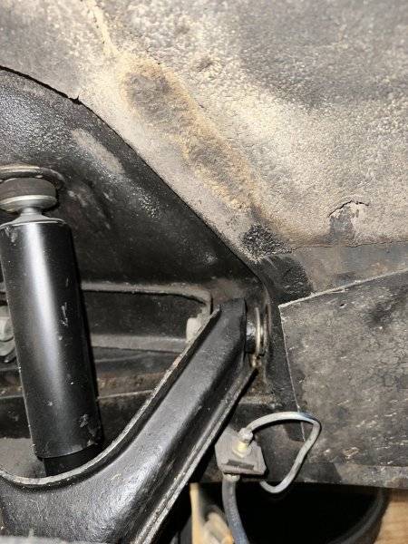

This cant be good.
How could the arm fit in the tight slots or bushing come out with the 1/2" cam bolts squeezing everything together?
Mike
You can see on the arm itself where it's bent inwards at the bushing, so my thinking is when the bushing was pressed in, a press was used, and it wasn't supported correctly and the arm bent. And it was just installed with the bolt squeezing the bushing...

Yep, looks like your arm is rotating on the bushing shell vs the rubber twisting back and forth.
and wore a portion of the shell away causing it to cock....guess we'll find out

Something is bent or faulty. Could be from previous collision damage. Not much point replacing anything until you determine what is at fault....& fix that first.

Just me.. I'd be getting another UCA... notice how it's bent on the bushing, more space on bottom than top? That's not normal, something caused/is causing the arm to bend. This how it should look..
Looks like you tire is rubbing the brake line. The line should maybe closer to fitting and have a tighter bend
Thank you sire, good eye... I just checked and it's not rubbing, I can get 2 fingers between it and the line. What you see is actually the blue paint from when I welded in the Z-bar mount and painted it.
(I'm glad it's not rubbing, it's been that way for over 18yrs!)
