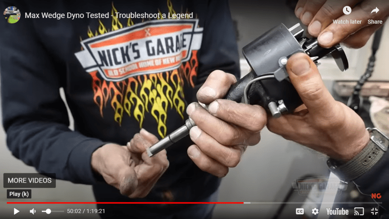

I am sure it is The MP electronic one I can tell by the advance plate with the built in reluctor. Good distributor, not seeing the screw on shaft. Hard to get internals for them. Not made for years and even then scarce, everything is specific to that Mopar electronics inside it. I get them usually welded to lock them out for crank triggers!![]()

They said it was an iron dual point converted to electronic. It looks like a Mopar pick up coil but the reluctor is really different. It’s a good idea that seems poorly executed…I am pretty sure it is the MP distributor, no idea why that was done to the shaft. Leaning towards it was a B dist modded to fit a RB engine. Not a good idea to me right up there with the collars people put on the shafts.
