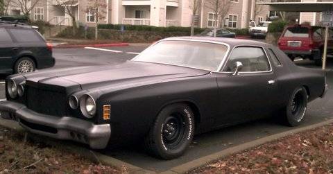

Here's a (not great) pic showing 265/60 16s on 16x8s w 4.75" bs on the back. The front has 235/60s on 15x7s, 4.5" bs... but I should have gone 245mm. In this picture the rear ride height is 1" to 1.5" lower than normal... I had just replaced an air line.
