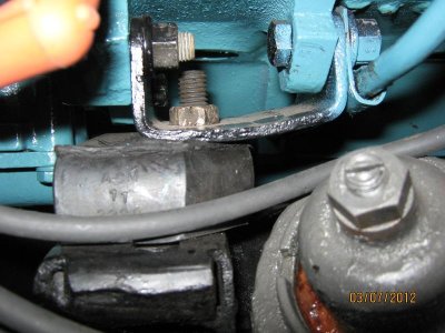

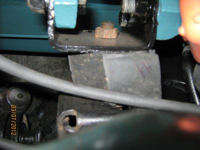

If possible I to would like to see a couple pictures of the engine mounts installed on a big block in the car 62-65 B body that is. The reason i ask is when i put the engine back into my 65 coronet the z-bar seems to be at alittle angle. I also noticed that the passenger side mount is either made twisted or in a bind. I am thinking possible the parts store gave me the wrong mounts, but i don't know for sure. Of coarse i to could have made a mistaken putting them on as well, they were off a good while. I am going to upload a couple of pictures of mine installed. The first is of the LH drivers side and the second is the RH passenger side showing the twisted mount. Could just be i need to replace that RH mount? Please let me know what you think!
Matt

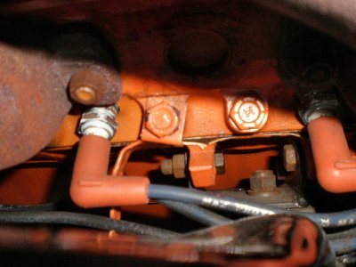

Here's a shot of mine:
Passenger side:
Driver's side. Now, the block in this photo is dimensionally correct, but it is not the standard rubber block. This is a solid steel insulator block which, admitedly, does not do much insulating, but it's not nearly as bad as people think it is. I made it years ago in HS metal shop class and I've carried it around to multiple cars since '87. However, I made it from a new rubber block that I had at the time. The width is correct and the studs are in the right place. I figured I'd give that explaination right up front because somebody's gonna ask why the corner's not cut off.
-Hemicbx

I'm having a little trouble telling what I am looking at in your motor mount pics Matt, but are your engine brackets mounted on the front or the rear of the block's mounting ears? Here is a pic of mine on the driver's side where you can see they are mounted to the rear face of the ear. If they are mounted to the front, it could cause the twist you are seeing. Do your mounts have the two bolts going to the k-frame?
Yes, My engine brackets are on the rear of the ears on the engine block on both sides. And Yes the rubber mounts both have the 2 studs that go into the k frame. As best I can tell the RH mount is number 2227 and the LH is 2228.
Matt
Matt
Matt,
Don't know what you have but something is out of wack.Here are my 62 mounts,can't see all of the passenger side but everything is straight and not twisted.Your brackets are on right,has to be the rubber mounts.
Bill
