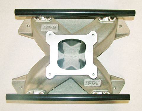

I have trick flow 270s on my 512/400, which means the only intake option I have is the Indy 400 I-2 or the 4500 version.
I did notice for an extra $500, Mancini sells a version set up for fuel injection.
Is the difference worth it? What all do you need to run that vs throttle body efi?

I would get the manifold from Mancini and build a Multi Port set-up.
What all do you need to set one up?
The easy answer is a Edelbrock Pro-Flo 4 and use the Mancini manifold and fuel rails instead of the Edelbrock.. Or build it using Holley parts..
