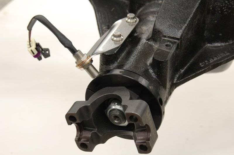

My dashboard has a driveshaft speed tach next to the engine tach so I can watch them both. I can also data log them so I know exactly how much converter slip I have in each gear. I also data log the line pressure in the transmission as well as the fluid temp. That way I can have an intelligent conversation with the transmission guy when it comes time to make changes.
